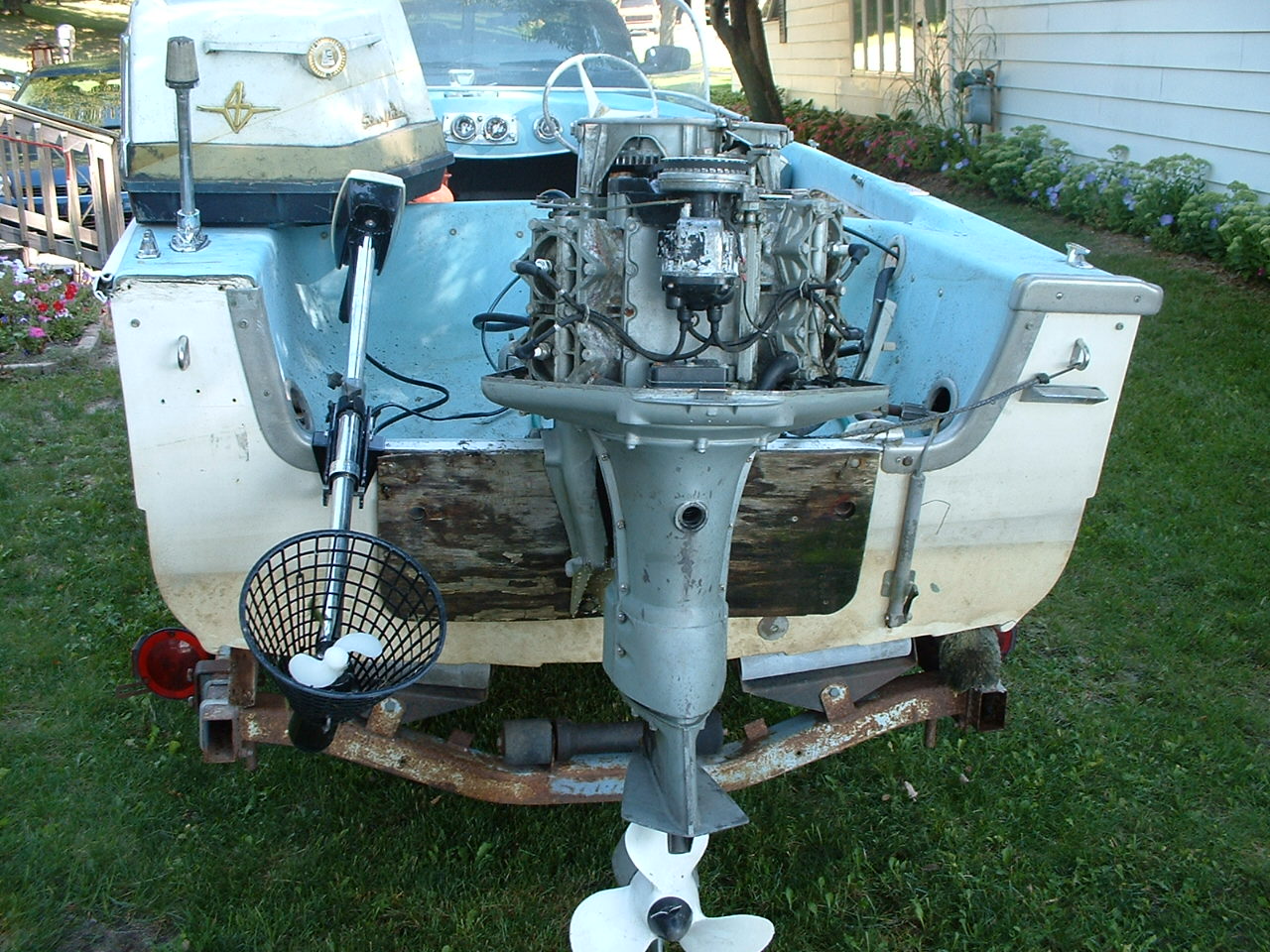

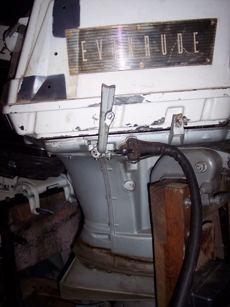

OK, after looking at Clark Savages thread I got concerned about how my"Fatty" is mounted. Didn't want to steal his thread. Below is how mine is mounted to the Clipper so I guess I need some reassurance that it's ok to do so. Mind you this is how it's been mounted from the day it was bought. Doesn't mean it's right but just need to know please. :unsure:
What do you think/
Re: Mounting my '59 Fat Fifty 15 years 8 months ago #27125
Your 50 is mounted correctly. Those brackets are NOT NEEDED on the fat 50.
Too much wrong info is out there.

Thank you sir, I feel better now. :laugh:

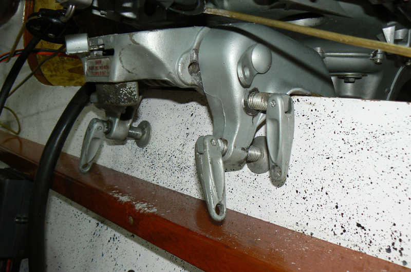

Looks OK to me. But I'll have to look at how mine is mounted on my Larson All-American, Transom clamps and two bolts at the bottom. ;)
Re:Mounting my '59 Fat Fifty 15 years 8 months ago #27151

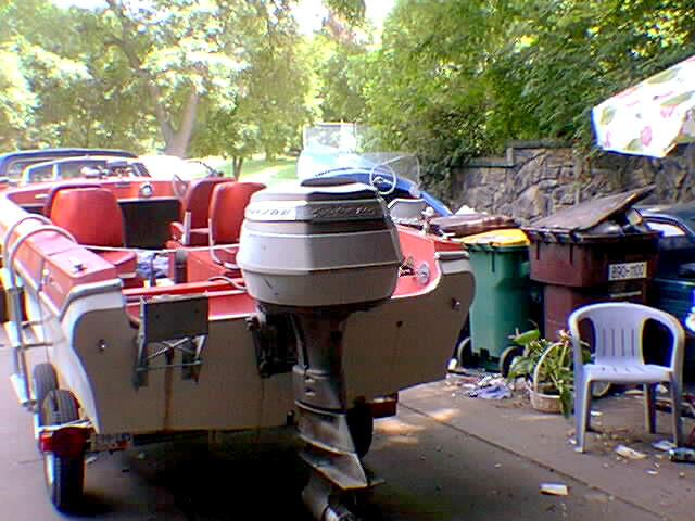

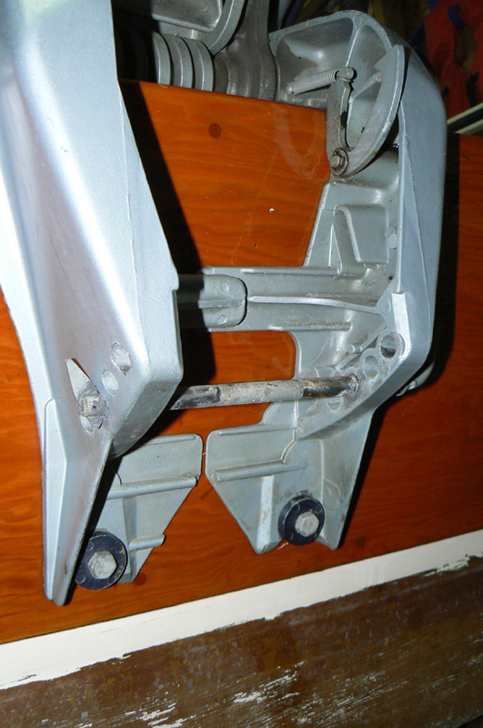

The '58 "Fat 50" had transom clamps, the '59 60 I think had brackets. The '60 75 was a different block and lower unit and had brackets. At least mine did. The best of all worlds is the '60 75 with the Fat 60 hood.

In 59 they came out with a 60hp, in 60 it went to 75hp yes they used brackets.

My 59 V-4 Fat 50 (which is for sale) has transom clamps not a bracket set up like my old 100 HP Meteor did.

Jim, yep that's the set up. Thanks

I'm wrong. '64 was the first 60hp. I had one once, so then the 58 - 59 50hp had clamps, Everything else (4 cyl) had brackets.

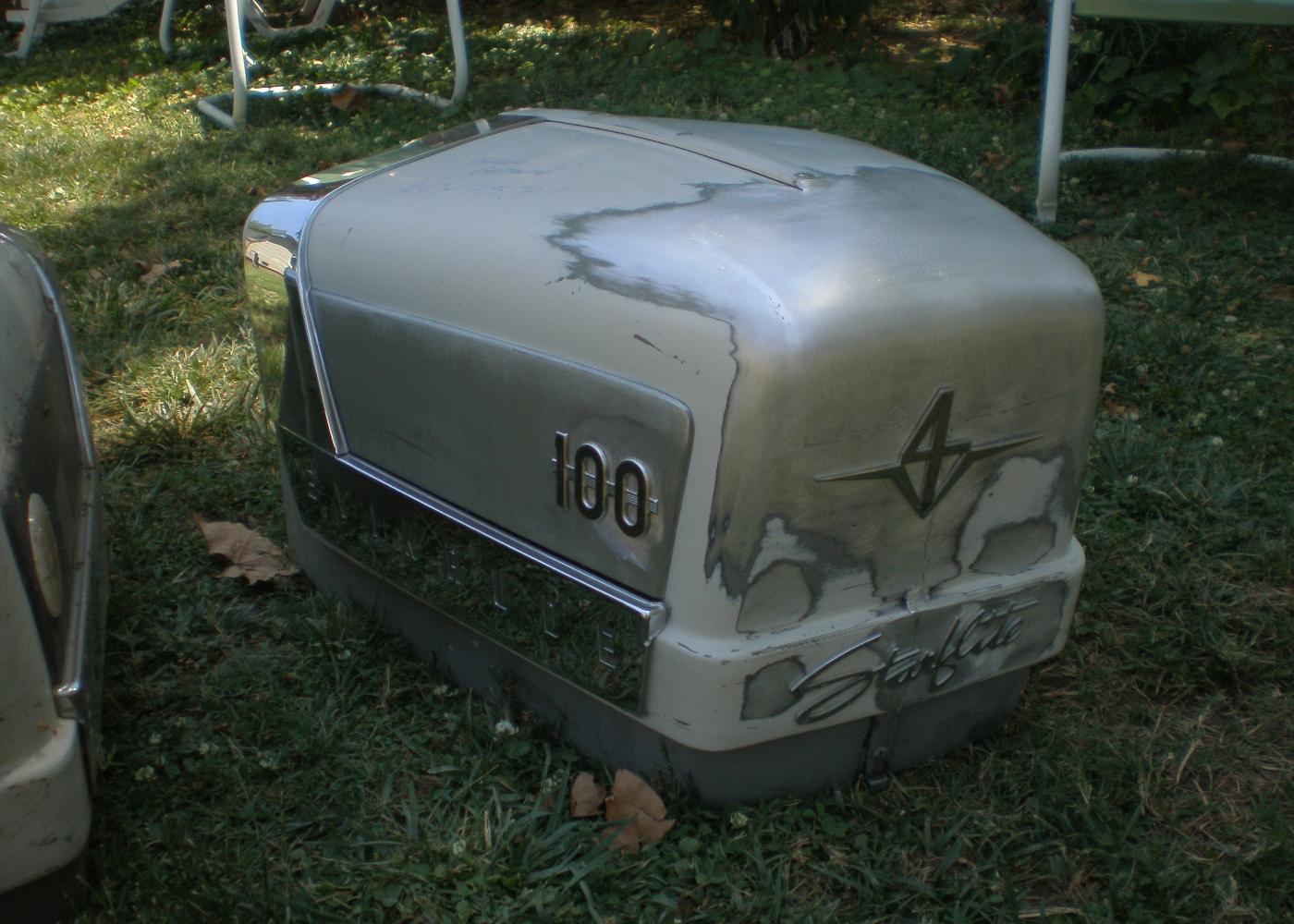

After 10 years of fooling around with the pre '68 V4 engines, I've come to the best conclusion for my needs is for use a 100 HP engine with the bottom pan and hood of an earlier engine. The old Evinrude lids will fit over the 100HP powerhead - but barely. I don't know if the Johnson lids will. The 90 & 100HP engines used an inline 4Bbl sidedraft carb - different than the downdraft 2Bbl "toilet" used on the 50 thru 85 hp engines. I had to shorten the length of the idle needle valves on the 100 carb to make it possible. I then went a little wild on the Starflite I lid. I shaved the emblems and had the seams and carb door welded closed. I found some cool "100" emblems for a tractor - they look period correct & are stainless. I stole the rear script emblems from a doner motor, and these will be mounted on the front. All the parts to do this bolt right up, if you know what ones to use. It'll make a pretty nice sleeper, and is bound to hurt the ego of a few Merc owners. The 90 & 100 burn significantly less fuel than any of the 2 Bbl motors, while making more power from the same cubic inches.
Bruce
