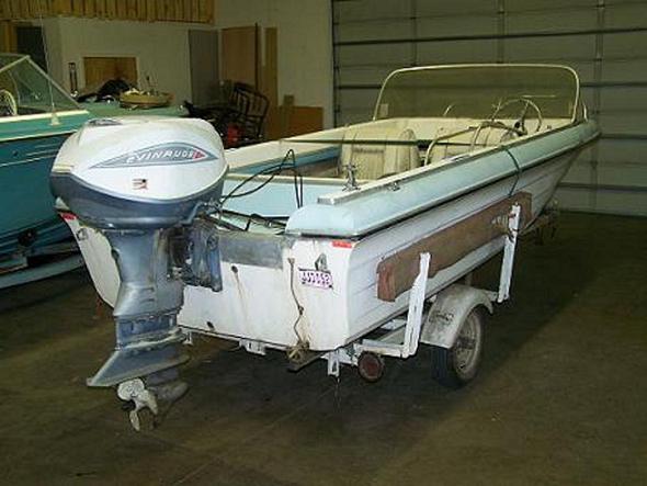

I have found what would appear to be the correct vintage motor for my 1964 Evinrude Sport 16 boat. The owner is asking $500, but he says the motor has not been run for 4 years and never by him. He says the motor is clean, turns over, and appears to never have been run in salt water. (I don't know how he would know where a 47 year-old motor has spent it's life :unsure: )
All I have so far are some pictures of it taken through a chain link fence. It looks to be clean as new. I would really like to have it to match my boat.
What would be a reasonable price? He's asking $500.

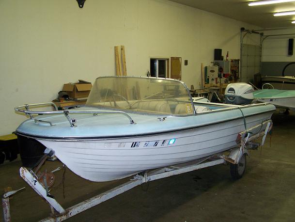

I just returned from the three-hour round trip to purchase and pick up the motor. It's still sitting in the bed of my truck. I think it will be there until I get the old 40 horse Merc off the stern, the old seats and carpet out and the topsides painted. Shouldn't be more than three or four days (Ha!)
Here's what it looks like:
We took the cowl off for inspection then left it off to make the lift into the truck bed easier.
I see it has a nice bail on the top for hoisting.

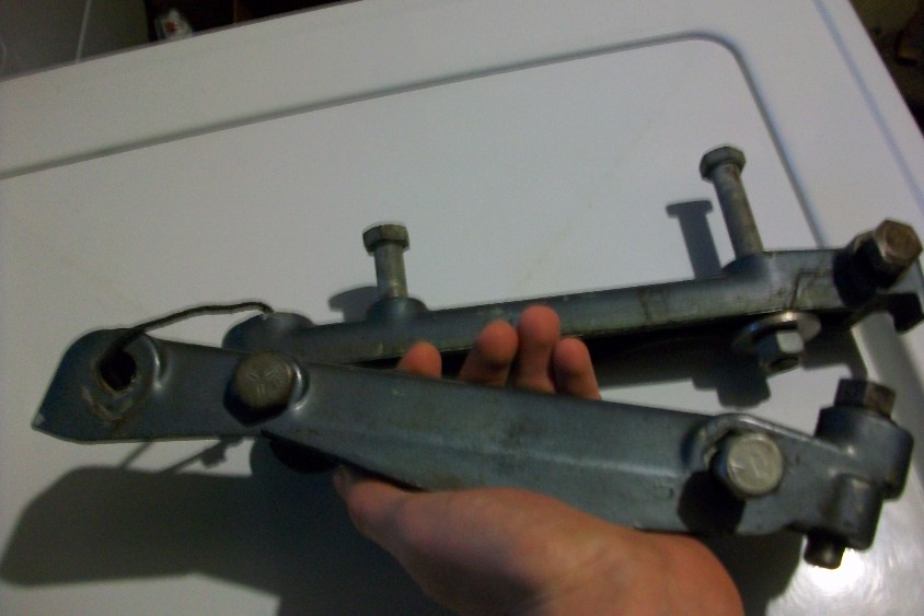

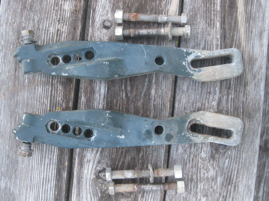

Special mounting brackets were used , they bolt to the transom and the motor slides in from the top, locks in with a couple of bolts.
The brackets should be easy to find at any old time dealer.

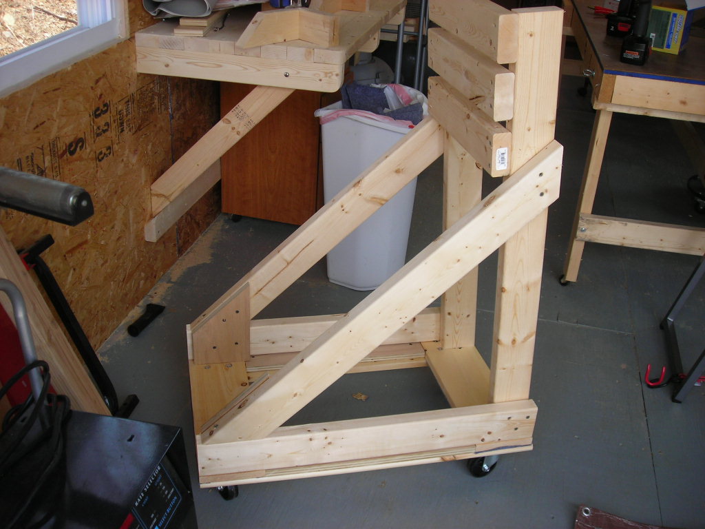

But first things first- you'll need to build a motor stand to hold the motor upright for storage and working on it.
This thread has some other examples of motor stands:
www.fiberglassics.com/fiberglassics-forums/main-forum/motor-stands#15084

These are the type of transom brackets you need. They mount on the outside of the transom. I bought this pair of brackets a long while ago for a motor I no longer have. I believe they are for the 58/59 50 HP models(?) but are interchangeable with all the '60s V4s.

When I spoke with my son today, he also mentioned building one. I have a permanent one built on one wall of my garage which now has a 10 hp Merc, a 4 hp Johnson, a 2 hp Johnson and an electric troller. No more room there and it is not located under my chain hoist. I think I need a rollabout.
I was thinking about building one out of lumber and setting it on top of a nice Harbor Freight Tools mover's dolly I have. That way, with four wheels, I would never have to tip a motor to move it. I will certainly look at the design(s) in the thread you mentioned.

Re:How much should I pay for a 1964 75 hp. Starflite 15 years 8 months ago #26529
If you need them, I have a set of the motor mount brackets available...

I purchased and assembled a Harbor Freight Tools engine stand yesterday and today made an adapter plate from plywood, hoisted the engine out of the truck, and mounted it on the stand.
Not really happy with it. Since the point of rotation is below the center of gravity of the engine, it wants to rotate upside down. I'll probably torch cut the vertical arm on the engine stand and extend it 8" or so.

hi clark,its nice to meet you,im the one with a 63 starflight/blue selectric shift,in handy andys link,on removing a motor,
i also built a stand using a harbor frieght dolly,20 bucks,and it works great,you can see part of it in the pic in the link.
here is a better pic of it and the fold up tables i made in my garage,they all come in handy.john
