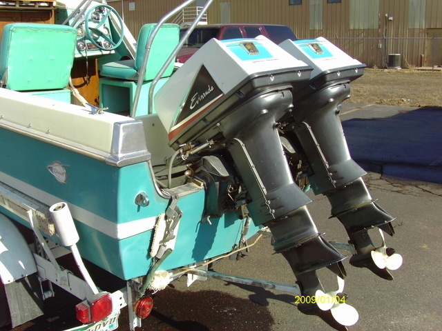

And anyone tell me the year of these 40 HP motors. they are on a 1964 Dorsett catalinia.
thanks for the Help

1960.. Beautiful motors. B)

Re:year of evinrude motor? 16 years 7 months ago #2628
Thanks Guys,
I'm trying to figure out if they are auto choke. the start plate i have on the boat isn't for twins. some one took a single start plate and used it. so it has a start key hole, and in the choke push button hole put the second key switch. so i guess it has to have auto choke on them. right?

The 59 model year was the 50th anniversary series and it certainly was different.
These 2 motors appear to be 1960 models.
Re:year of evinrude motor? 16 years 7 months ago #2634
You can check out the 1960 Evinrude Brochure here: www.old-omc.de
1960 was a year with automatic choke.

You are correct, they are 1960 models. I'm not quite sure why I said '59... I have one of each so you would think I could keep them straight. LOL

I've had a 1960 Evinrude 40 hp. Lark, like yours, on my boat since 1963. The original carburetor had an automatic thermostatic choke feature, which was controlled by engine cooling water running through the choke housing. The choke has three settings; off, auto, or manual on. I removed the water housing feature from my carburetor many years ago. It bothered me that the choke stayed partially on far longer than was necessary. But since I still pull on the starter cord, I don't need an auto choke or an electric solenoid controlled choke. I just use the manual choke setting. For your installation, you could use either dual choke buttons, or use a double throw switch to activate one choke, and then the other from a single choke button. Alternately, I guess some ignition switches use an additional key position to activate the electric choke .
