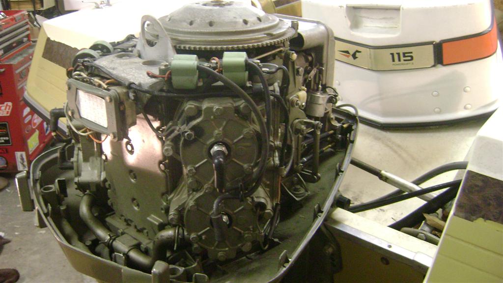

Recently purchased, been sitting up for a few years. Just wanted to get organized into one thread for ease of reference. Only previous experience on anything of this size was on Merc700FGS, so this is all new to me. Had the wrong spark plugs installed, got the new proper ones ready to go in when we get to that point
The compression check was good, 'bout 149 on all four holes!
Spark check good, nice blue flame across each plug - so far so good.

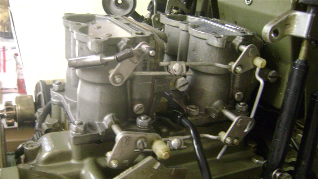

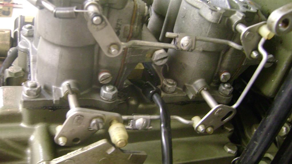

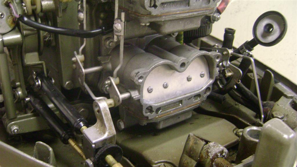

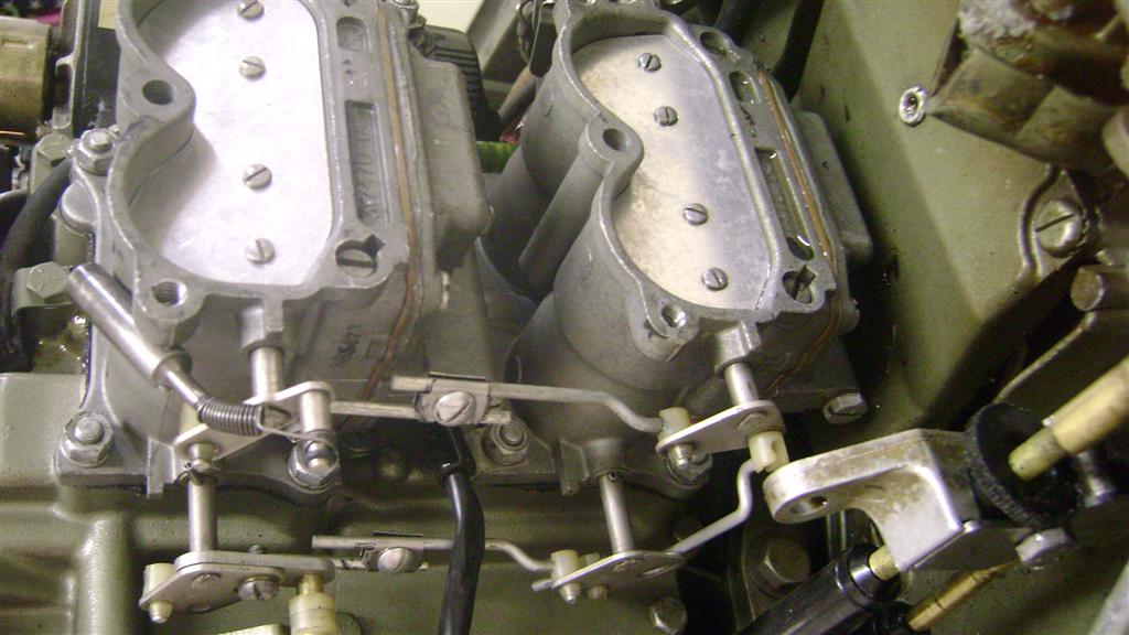

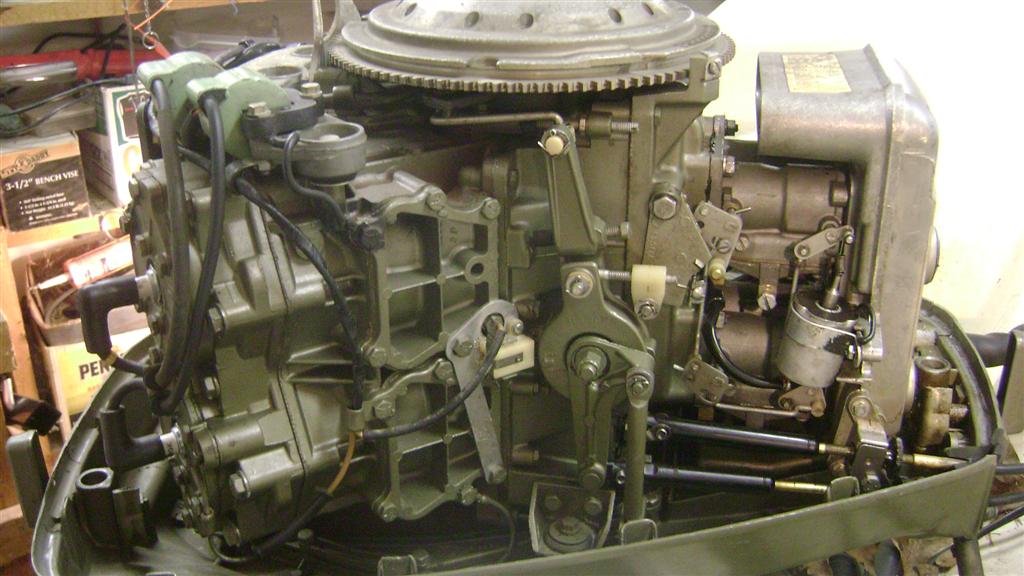

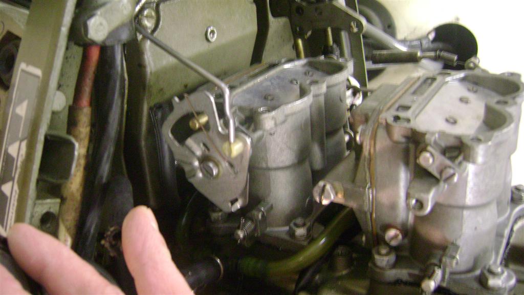

Getting ready to refresh carbs and fuel pump, pics for reference on linkage, hoses, etc.
Did I mention someone used black "form-a-gasket" on carb to silencer and carb to intake mounting? NEVER a good idea folks!

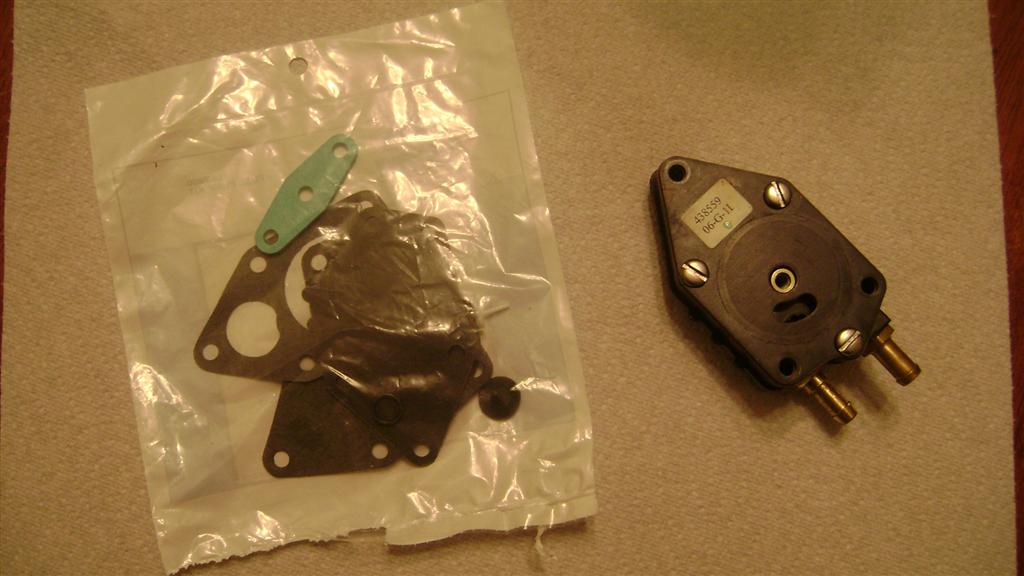

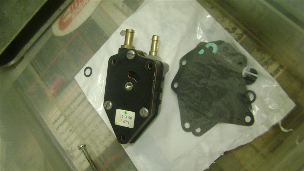

Fuel pump is newer high output model according to the shop manual, really doesn't appear to need the kit!?

Anybody have an exploded view/diagram of the 438559 fuel pump? I was kinda tired when I put it back together, wanna make sure I got it right! My biggest question is the placement of the small oring
Also just noticed the green gasket that goes between the pump and the silencer wasn't on there when I took it apart! :dry: And he wondered why it wouldn't idle. Guess I'll have to break that kit open after all.

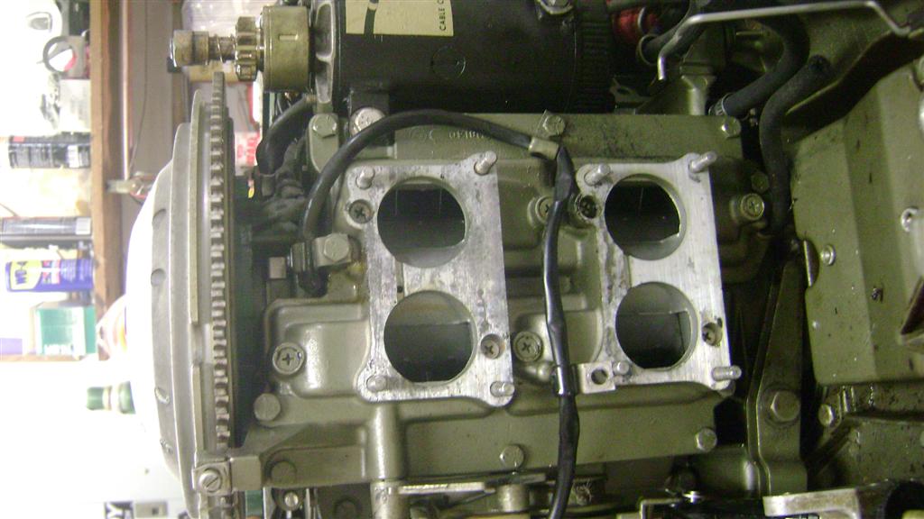

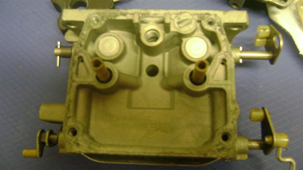

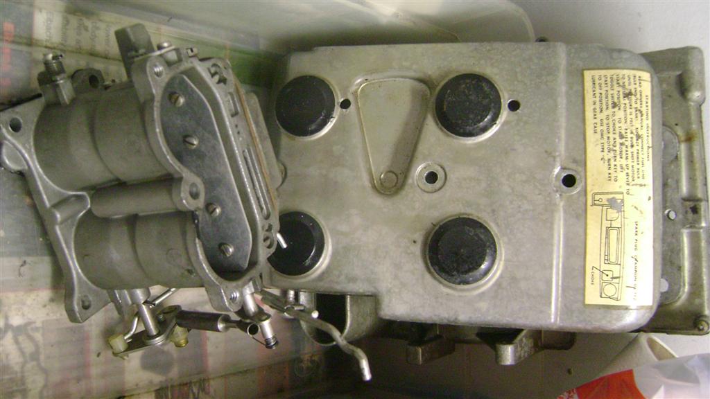

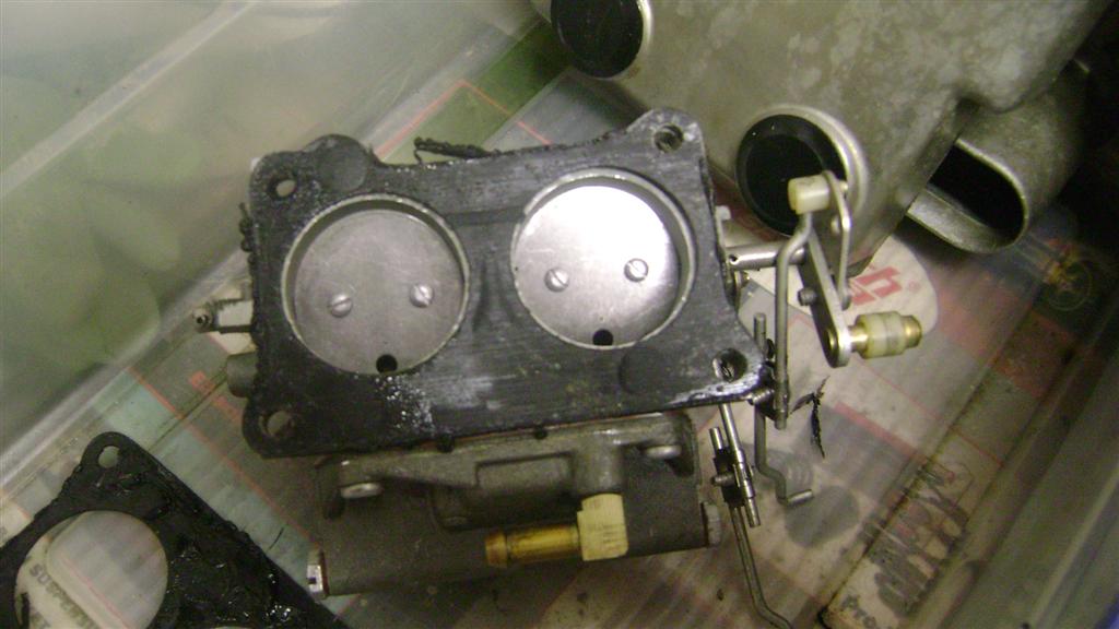

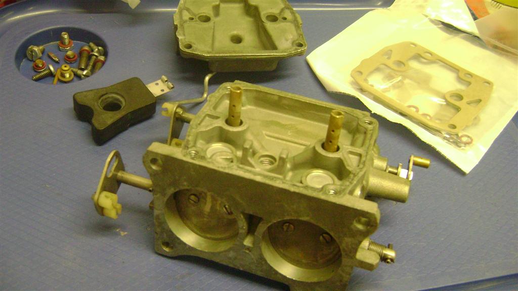

Pulled the carbs off today, black rtv silicone everywhere! What a mess. It was down in the float bowl too, so this is definitely a BAD IDEA to anyone thinking about using this stuff on carbs or fuel pumps.
I need some advise/guidance on how to safely remove the "welch plugs" you'll see in the last pic below. I really need to clean out all the bad gas and chunks of silicone. I have blasted carb cleaner through all the holes and orfices, but something tells me to pull these plugs for inspection, if nothing else. The carb kits contain new ones, I just don't want to bugger up the carb housing getting them out!
Re:1973 Johnson 115 Major Tune Up! 16 years 7 months ago #2600
Simple ---take a 3/16" drill bit. Put some tape on it so you will only just drill thru the plug.
Pry them out.

  • MarkS's Avatar Topic Author
Thanks, Adrian, I'll give it a go. After cleaning, just put the new ones in place, put a socket (or something flat) on it, and whack it with a hammer to flatten it out , right?
