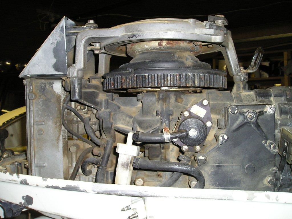

Is there a way to find out the year of a power head.
I only have the number on it is the aluminum plug number that is on top of the motor.
It is G3128068
There is not a dealer withing a 100 miles otherwise that would be my first stop.
Sorry no pictures just debating whether to buy.

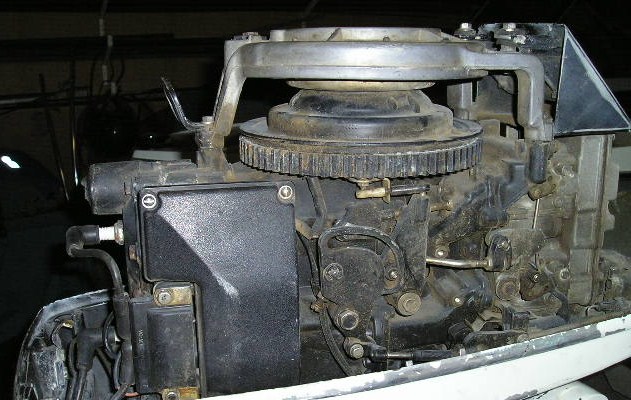

Other than that number all I can tell you is what I was told.
It is supose to be a 2cly 55 hp pull start from a tiller model.
I was just sent these
Re:Year of my Johnson 15 years 10 months ago #22938
Looks to be a mid 80's " commercial model "

Re:Year of my Johnson 15 years 10 months ago #23000
That thermostat set-up is first shown for the rope models in 92
according to
shop.evinrude.com
check it out.

Re:Year of my Johnson 15 years 10 months ago #23034
Definitely post 1990. They changed a lot of things with those motors in that era (late 1980s/early 1990s) so there isn't much compatibility with the earlier big bore 2-holers...
