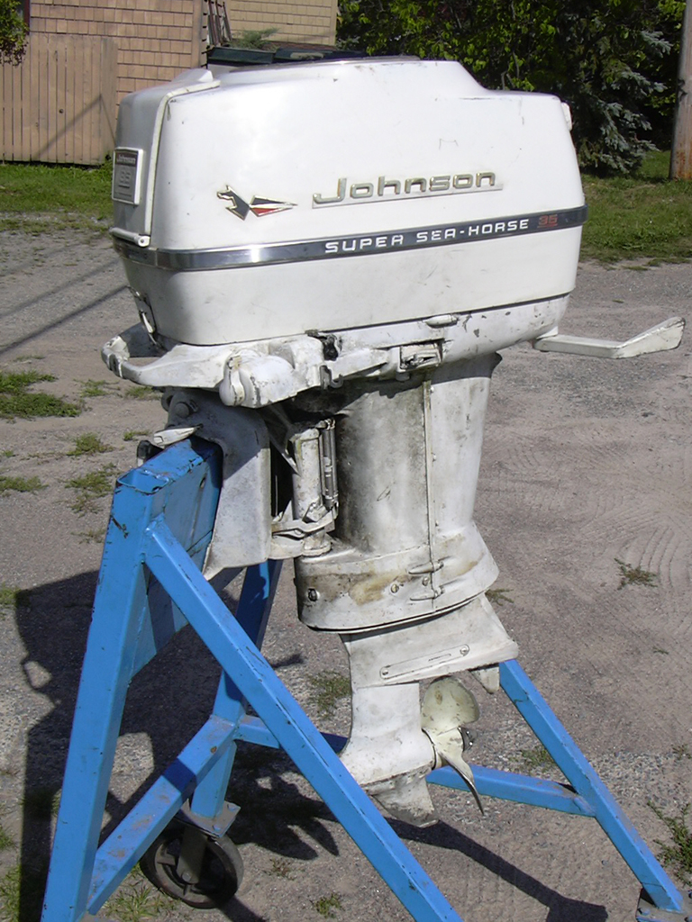

That is correct. The '58 and '59 Lark models are the double-wall mids with bucket cowls. In 1958 the Big Twin 35 model was a single-wall mid/clamshell cowl. The 1959 Big Twin 35 was a double-wall mid/bucket cowl (all blue, with gold and white accents). It took them two model years to phase out the single wall model and phase in the double wall.
A little easier with Johnson... They had the transition year in 1958 with both single and double wall models offered (standard bronze & white Sea Horse 35 with the single wall and the gold/white Super Seahorse with the double), but only one model offered in 1959 as the all white Super Seahorse 35 with the double wall.
- Scott
1958 Johnson Sea Horse 35 with single wall mid and clamshell cowling.
1959 Johnson Super Sea Horse 35 with double wall mid and bucket cowling.
