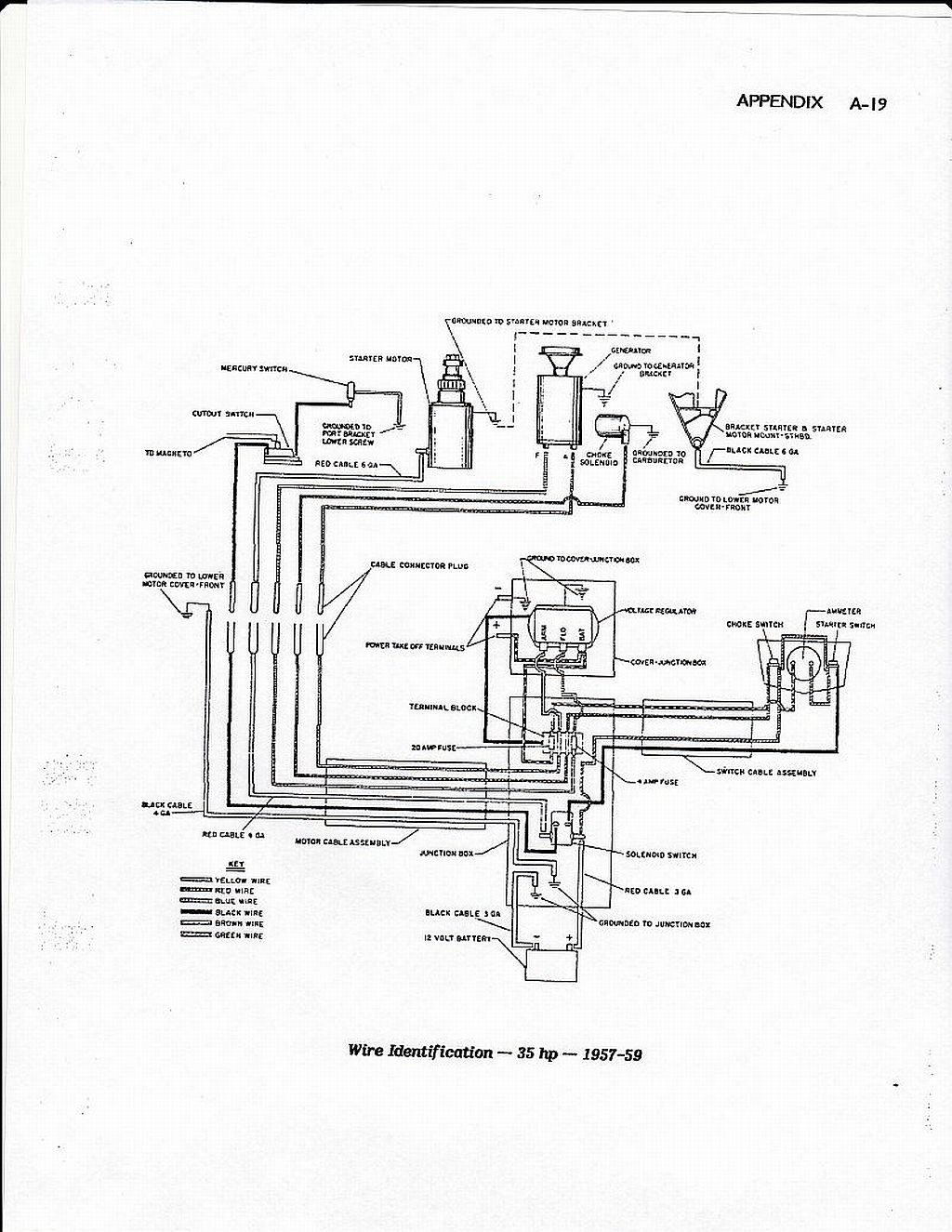

iam in need of help on telling if a 1958 johnson super seahorse 35 hp model rds 20 serial # 185401 is 6 or 12 volt and also where i can get the lower cowling that goes from the cavation plate up

It's a 12 volt system.
