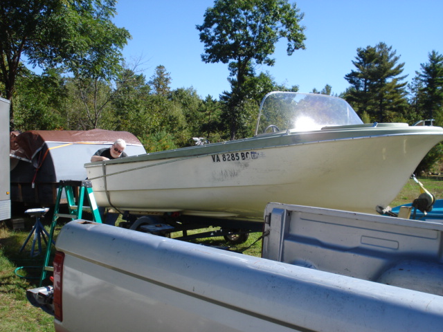

I'm in search of a motor for my 1968 Corson 17 ft which I am in the process of restoring. I've come across a 1986 Johnson 60 hp with all controls and power trim/tilt. It's for sale at $1,500 with a 1 year warranty starting next season. First ? Is this year/hp motor any good- prone to breakdowns etc.- Second ? Is $1,500 a good price.
I'm a first time boat owner but have been restoring muscle cars for years. Any assistance/recommendations would be great. Thanks in advance

Yes I did check out the shop- Very competent,clean, with up to date equipment. There were several motors their being worked on. Since the season is over here in Maine I think I'll continue looking for a motor. I've had a few leads on motors- might find a used one I can run for a year or two and rebuild it at a later date.
In the mean time I'm busy working on the hull of the Corson. Removed the deck and found the transom needs rebuilding. Following the post on transom work. Completed reupholstering the seats.
