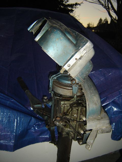

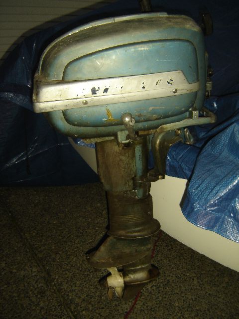

okay,i just got this engine and don,t know much about it.i know it is an evinrude and the cover open side way.the serial # is 15012 78446.it seem to be in good condition and everything move and turn well.when i pull the cord it puff pretty good.can someone post a pic and tell me what i have.thanks

Model number 15012 is a 1953-54 Evinrude Super Fastwin 15 HP motor - check out the original brochures at www.old-omc.de
This is about the same engine that Peter is working on:
fiberglassics.com/glassic-forums/j-e-g-o-s-place/scrape-pile-evinrude-rebuild
A good reference for Evinrude and Johnson model numbers is at the following link:
www.marineengine.com/parts/parts.php

As for year I would say a 1957. I have a 35hp that looks almost just like it.
