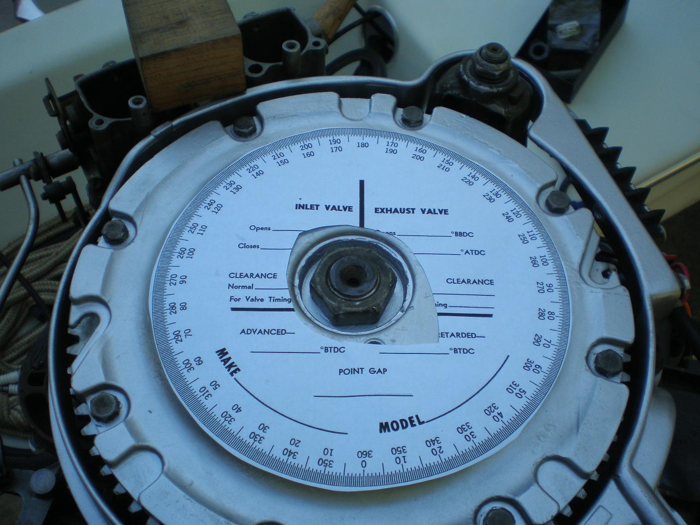

The generators are all the same, except the V4 kit did not have the bracket. The V4 kit included the belt & the cog pully that attached to the bottom of the flywheel. It also had a different cover for the switchbox that had a big Delco regulator inside it. The regulator box is the hard part to find. I encourage you to find the parts from a 1967 V4 with a flywheel/ alternator & rob those parts for your engine. You will need the flywheel, stator, top bearing cap, and flywheel guard. This sounds complicated, but it's actually very easy. It also gives you an opportunity to replace the upper crankshaft seal - as they are almost always leaking by now, causing a lean condition on the top cylinder. It will produce more power than the old delco generator, and you won't need the regulator box because the '67 used a solid state rectifier. Another thing, the V4 drive belts for the generator are almost impossible to get, and NOS ones go for around 80 bucks. 1967 is the only year that the parts will correctly interchange.
Here is a pic of this conversion I did on a 1961 Starflite III. The alternator produces enough power at itle to run the engine & lights, while still registering a slight charge into the battery. This means that you can idle all day without the battery going down. The Delco Generator can't do that.
