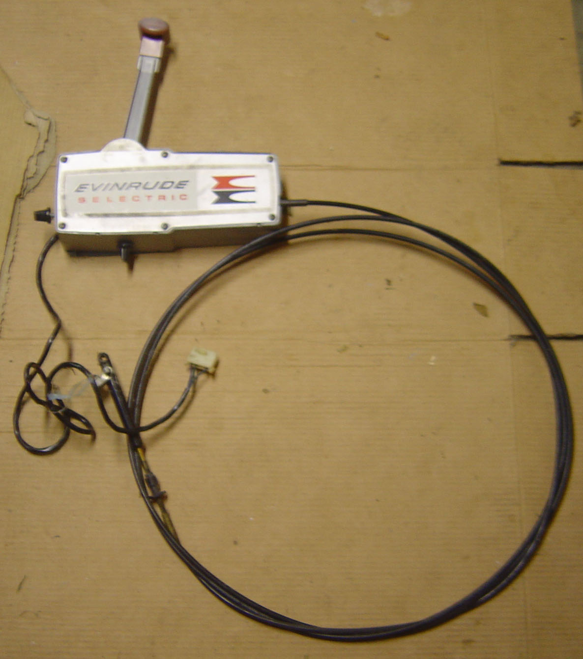

I believe any of the Selectric shifters back to 1960 will work with your engine and wiring harness.
What does your current plug from the shifter to the harness look like? If it is a white, rectangular 4-prong plug (but only 3-wires: Black, Green, Blue... though the black could be faded to dark blue)then I'm sure the earlier shifters will work too.
BTW- I have a very nice Selectric Shifter with throttle cable from a 1963 75HP Evinrude. I think the cable is 13'. It fit well on the 16' Starcraft Polara.
I don't know if you know that these shifters can be used on either side of the boat. The front and back covers are reversible to accommodate this.
There's also a shifter in the Glassifieds section...
