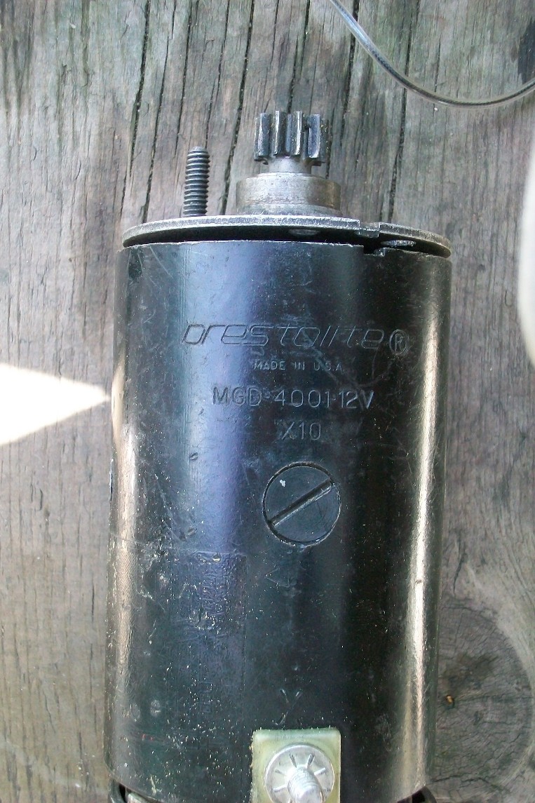

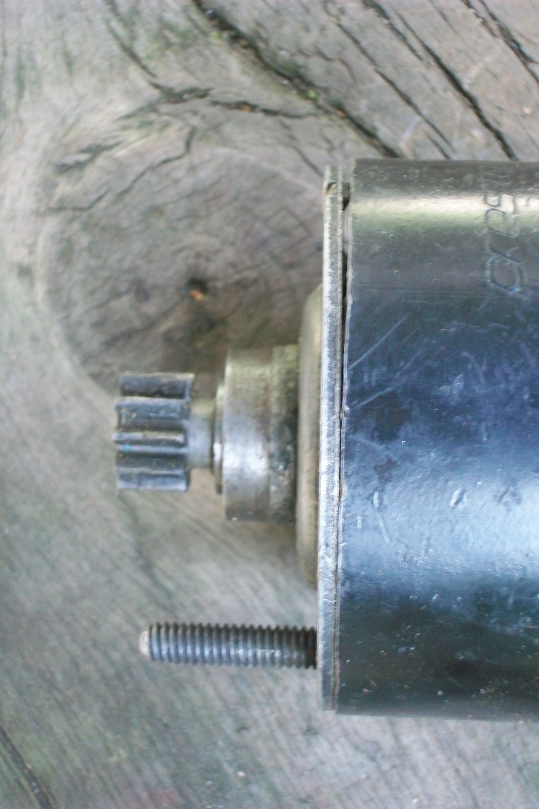

hey guys i have a 1966 evinrude starflite 100-s and the little gear mounted to the top of the starter motor, not the bendix gear. but it is ground down. like due to being not in line with the bendix. i am having alot of trouble finding either a replacement gear or a starter to fit my engine. please help. the starter i have is (Prestolite MGD-4001-12V)

Re:1966 Starflite 100-s starter 16 years 1 month ago #16825
Now that I see what starter that is I have one just like in your pix and mine has teeths miss on gear. HandyAndy if he don't want yours I will take it. I got a 65 Johnson 75hp short shaft the would go nice.

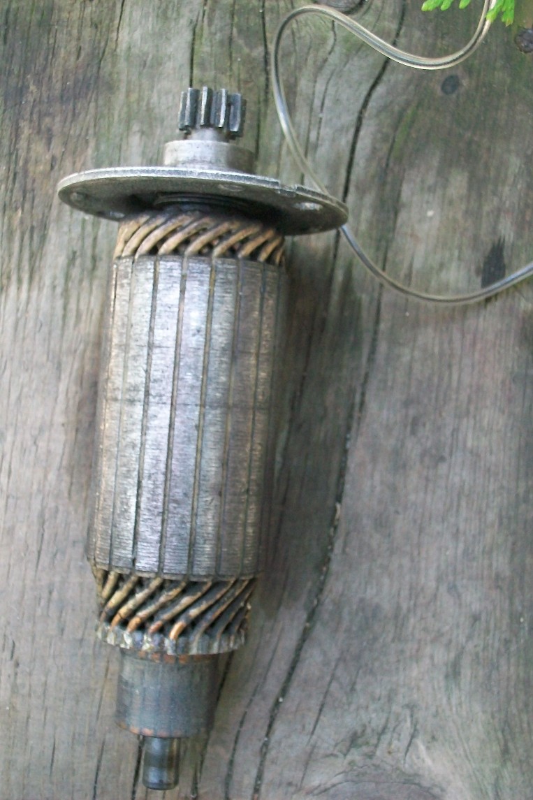

Re:1966 Starflite 100-s starter 16 years 1 month ago #16877
I did some checking to see if I could help you guys out with a source on new or rebuilt starters. The only people left who still even show the unit in their range is Wilson, 91-06-1910 & they have no stock and no cores to rebuild. Apparently the drive gear (commonly called a bendix) is actually cut into the armature shaft, and not a replaceable item like you would normally find in a starter. Sorry
