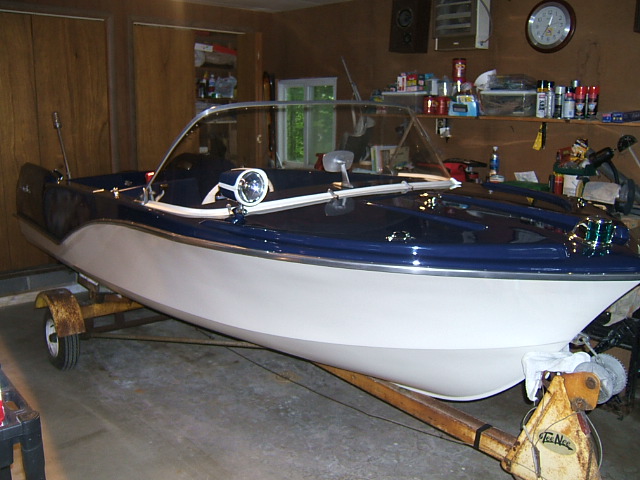

Hi, Glassers,Rick here.I can't start my
lark after a short trip this weekend.Engine started
bogging down after fifteen minutes of running.
When put in nutral and a brief throdle up,it cleared
but the bogging returned then shut down after a few minutes and would
not restart.I started out the day with fresh gas
with 50/1 mix and staybil.Had gas leaking out of
butterfly on to transon on restart.I get some backfireing when I start the engine for the first time in the day.I use it only a few days a year.Am I doing damage to the motor?There is gas in the glass bowl.Please note I know very
little about these engins or their workings.I have
a Seloc manual but would love to here your opinion
and a possible trouble shoot.I am about to stsrt the clean up
of my Super SeaHorse 35 for the Lake&Sea so its time
for engine 101 training.
Thanks
