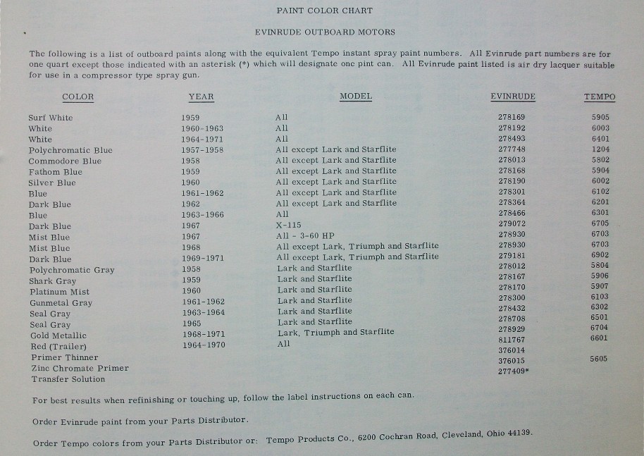

Hello all. Does anyone know what the paint codes are for the Evinrude Fathom Blue and Surf White. I've been searching everywhere and can't seem to find them. I know NY.Marine has the paint but I'm kind of on a budget and don't want to spend $20 for rattle can of paint. This is for my 1959 Evinrude Starflite Jubilee Fifty.
Any help would be greatly appreciated.

Seems most folks can get a good match by bringing a clean, unfaded part into a paint store and having them match it up. All the original Evinrude info I have come cross is long out of date such as this Tempo cross over list below:
Re:Evinrude Paint Codes 16 years 1 month ago #16390

Andy,
Thanks that should help some. And I thought I was the only crazy one up this late! LOL
