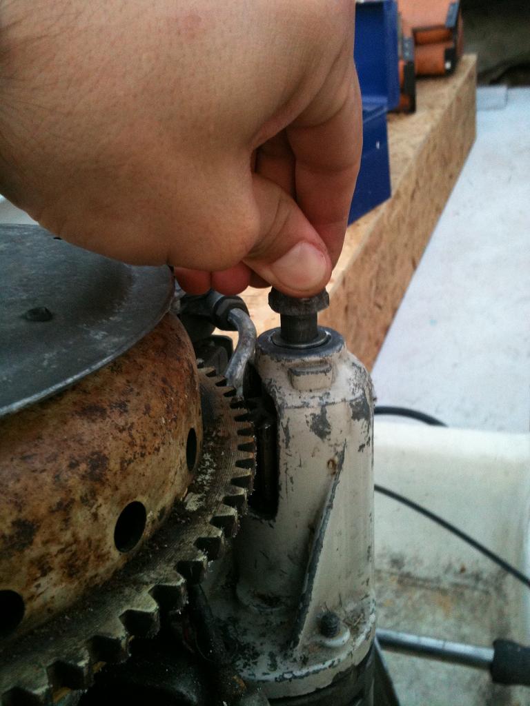

I have a 1966 evinrude starflite 100-S and I am having trouble getting the starter to fully engage. It seems as if when I turn the key the starter gear moves up the screw rod and is kept from going going any higher by a 1/4" metal bushing on top of the gear(like would be used to stop the gear from hitting the top of the bell around the bendix) my question is, is there any way to either raise the starter so it does not have to move as far. Or is there some way to adjust it so tha it can engage more and keep it from grinding the starter gear on the fly wheel gear.

in this image you can see how far the gear raises when it is engaged. (the bolt on top of the bell does not rise, just the gear inside the bell) and in this one you can see how far down it is when it is disengaged. i think that the entire starter needs to be raised so that it will catch on the flywheel more. i am not sure but that is why i am asking for help on here.

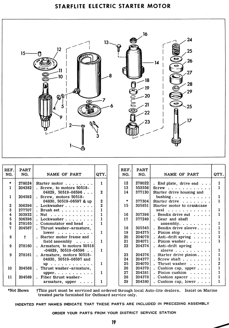

Something is missing in your starte if the shaft sticks up that high or you can pull it up that high. Here is a braak down of the starter so maybe you can take it apart and check it out.
Mike aka pathfinderz1

I think you will find that the "pinion stop" bushing item number 19 is missing or is under the pinion gear!

The starter motor does not need to be raised Sparky, it's positioned right where it's supposed to be. After checking to make sure all your connections are clean and tight, I would pull the starter off the motor and check the operation of the drive (gear). Move it manually and see if it slides up freely, there may be a bad spot on the shaft. If it does move freely to the extent of it's intended travel, shoot the juice to it and make sure it's spinning hard enough to engage the drive gear fully under it's own power. The condition of the gear teeth should also be inspected, as should the bushings and brushes in the starter. If the electric motor isn't operating up to par, it may not be spinning hard/fast enough to send the drive up into position.

Thanks guys for all your great suggestions, in the process of taking to starter off I found that the lower bracket that the 2 long bolts go threw was not tight agenst the block, and also found that the small bolt holding the upper ell to the block was missing, (mind you this boat and engine was givin to me) allowing the starter to tilt away from the engine. Once again thank your for the help and I will be sure to come here for my further help as this project continues.
