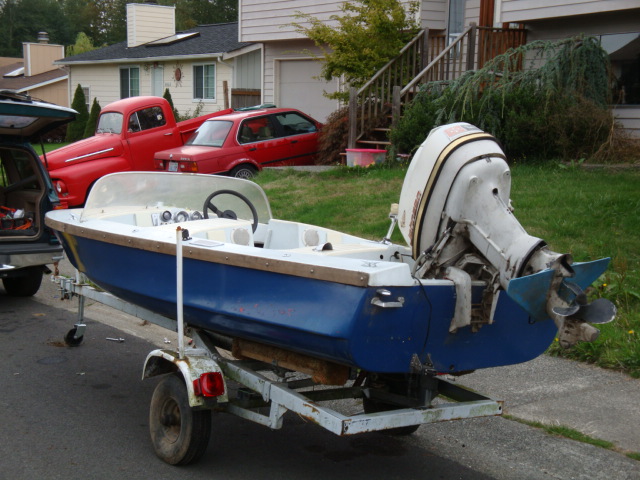

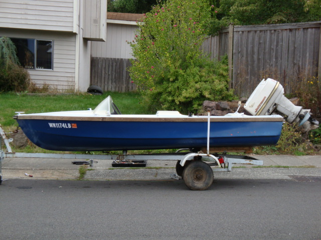

Just looking for help finding out what year boat and motor this is. im posting pics of both (hopefully, not sure in how to post more than one pic at a time) Anyway, finaly got her home to where i can start to work on her weekly..:) Any help on where i can get parts and a shop would be great! I live in Seattle WA. thanks guys!

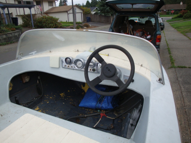

pic14 The boats been sitting under a friends deck since 2006 looked it over and didn't find any soft spots anywhere. the inside looks kinda bad but im not a expert. any help would be great! let me know if you would like to see more pics, i would be happy to take more...:)

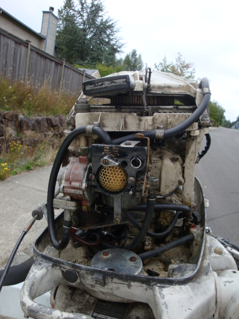

If you look at the tansom clamp you should find a tag with numbers on it. One is the model number the other is the seral number. Also you will find a welch plug on the motot top with the same numbers. Post those and we can tell you the year and hp.

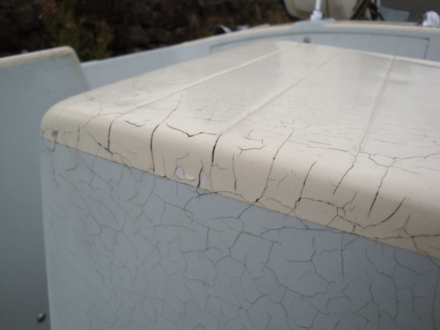

Wow, i have alot of work ahead of me...lol Yours looks sweet how big of motor could I put on it. How bad do you you think the paint is from the pics?

These are the numbers from the engine. Model# RDSL 24 M and seriel # 2286443 Once again guys, your great!.....can't thank you enough with all the help.
Re:40 or 50hp? johnson outboard on 1958-60? crosby 16 years 1 month ago #15755
RDSL-24 is a 1962 40HP Johnson

Great motor. Simple to work on, plenty of power to ski, parts easy to get. Your boat looks light enough to run fine with 40hp. JUST GET RID OF THAT FIN!!!!!!!!!!!

Yes. They are only a bandaid for a poor setup or underpowered boat that won't plane properly.
Re:40 or 50hp? johnson outboard on 1958-60? crosby 16 years 1 month ago #15804
That fin sticking out each side of the leg is also called a whale tail and they are good for breaking the cavition plate off. With the motor setup right you don't need it.

If it were me, I'd take the whale tail (dole fin, they go by several names) off and try the boat without it. It's hard to tell from your pics, but your motor appears to be mounted at about the right height. Chances are good that your boat didn't need it to start with! Many times those things were purchased under the pretense of the advertising hype; better handling, quicker planing, increased top end, etc.. You can always go back and fill in the mounting holes later, or reinstall temporarily (for testing) if that's what you decide to do.
Also noticed somebody just left the muffs on the motor, not a good idea. They can hold a little water in the passages that could freeze in the off season, enhance corrosion, etc. The unit needs to be able to drain completely, IMHO.
The Crosby has great looking lines, good luck with your project and keep us posted. I just became a big fan on the Johnny-rudes this year, hope you get it all sorted out.
