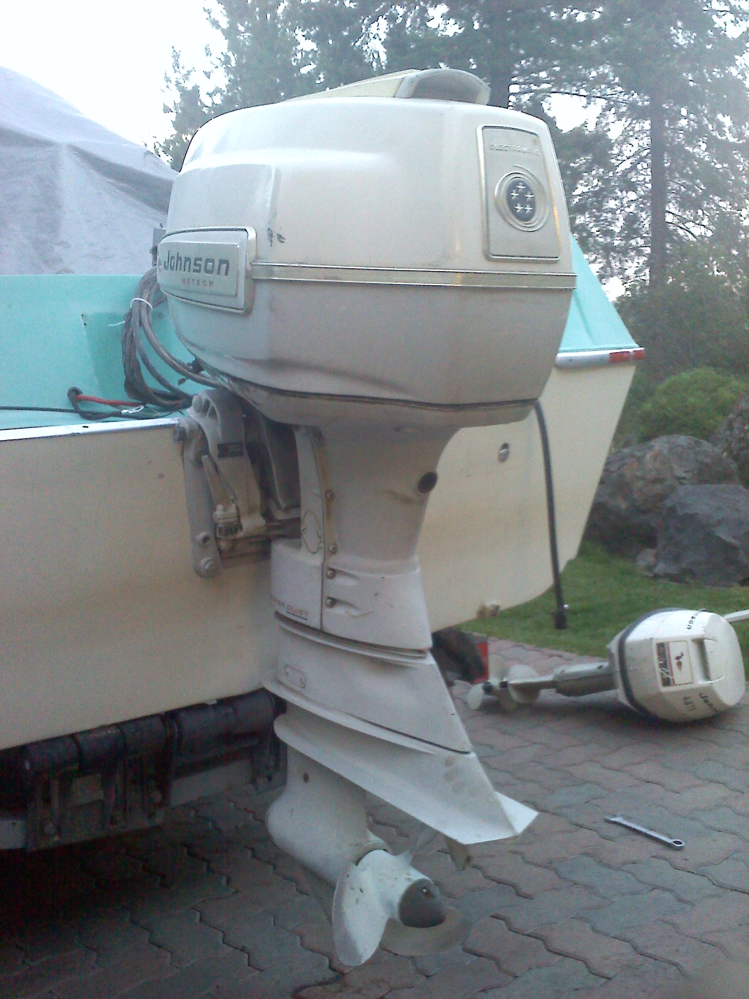

'66 Golden Meteor 100hp 16 years 2 months ago #14845
  • 64_Express
  • 64_Express's Avatar Topic Author
  • Posts: 185
  • Karma: 5
I decided to get rid of my old seahorse. So while I am tweaking the Homelite I scored this Golden Meteor 100 cheap. The good is that I did get it to fire up.....this is the motor just prior to the pulse pack ignition, and the compression is 120 in all cyl. The bad is that the only way to keep it running is to squirt a bit of gas down the carb barrels. I got the carb apart and it was a bit dirty so i gave it a good cleaning and blew out the passages but are there any secrets with the carb/fuel system on this thing? I converted to electric fuel pump so that shouldn't be the issue. I figured before I slap it back together I figured I'd ask.
