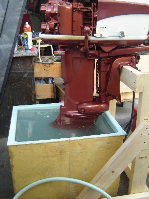

okay,i think my water pump is not working i have no water shooting out from back when i start this engine today,What do i need to fix it?where do i get the parts to fix it?how easy is it to fix the water pump?where do i start?thanks

First, lower unit isn't deep enough. Waterpump is at the bulge and must be submerged to prime - they're not self priming.

Test in your bucket with the water level ABOVE the bulge where the pump is located...

Before you go into the water pump, I would stick the engine into another bucket such as a trash can or something where you can get the static water level above the pump. You may have an airbound pump the way you are currently trying to test. Am betting it will pick up water, however......now that you have run the engine this way you may have already damaged the impeller blades and the previous post should be followed in order to inspect and replace as necessary. One thing I would add to that post is that if either the lower plate or the top of the impeller housing is grooved I would replace the complete pump assembly. Damage like that allows less than full pressure and volume to the engine. That is a beautiful engine from the looks of it!
