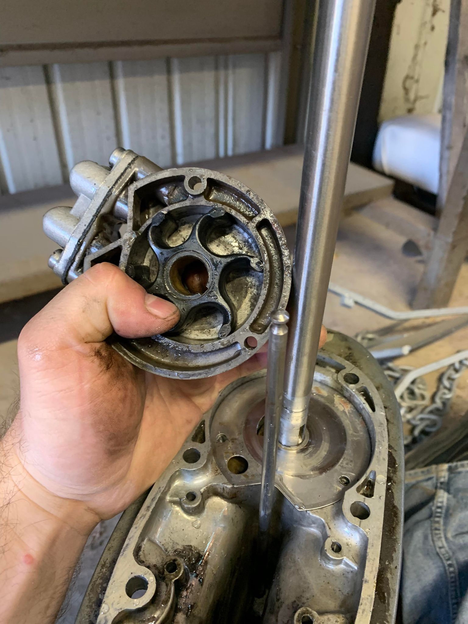

I have a 1963 Evinrude 40hp Big Twin. I've never owned a boat before, but know about engines. It idles very high, and doesn't seem to be pumping water. Throttle cable is new, and adjusted correctly. Throttle blade opens and returns fine. Carb looked fine inside, but I replaced the needle and seat since I had it open. In this video the lean/rich screw is tuned all the way in (lean), and it seems to do nothing. The float is level. My carb rebuild instructions show a high speed needle in their diagram, but I just have a bolt in that location. Is that correct?

I'm seeing in other forums that the lower unit needs to be very deep in water for it to pump, does it look deep enough in the video? The water level is a few inches above the water intake port. Also someone mentioned that you need exhaust backpressure to tune the carb? Not exactly sure what that means, but does my engine need to be deeper in the water to tune the carb? Help! Please see the attached picture, and the links

Okay, I dropped it in the pond and it does seem to be running much better. However, it is still not pumping water at all. The impeller is brand new, I made sure the keyway was lined up when I installed it, and the old one looked fine. I didn't see any passages clogged up. The shaft spins when I turn the prop. The lower unit was empty, I filled that with Type C. I shut it off when the temp gun was reading 198 degrees. Thermostat not working? I looked inside and it seemed okay. How do I remove the retainer thing for the plastic ball?

Is it possible for the impeller to be in backwards? The new impeller was the same size as the old one. When I removed the old one some of the blades were facing the opposite direction. I've heard they are supposed to flip around while moving, but they clearly were not doing that.
1963 40hp Big Twin idling high/water pump? 3 years 5 months ago #147955

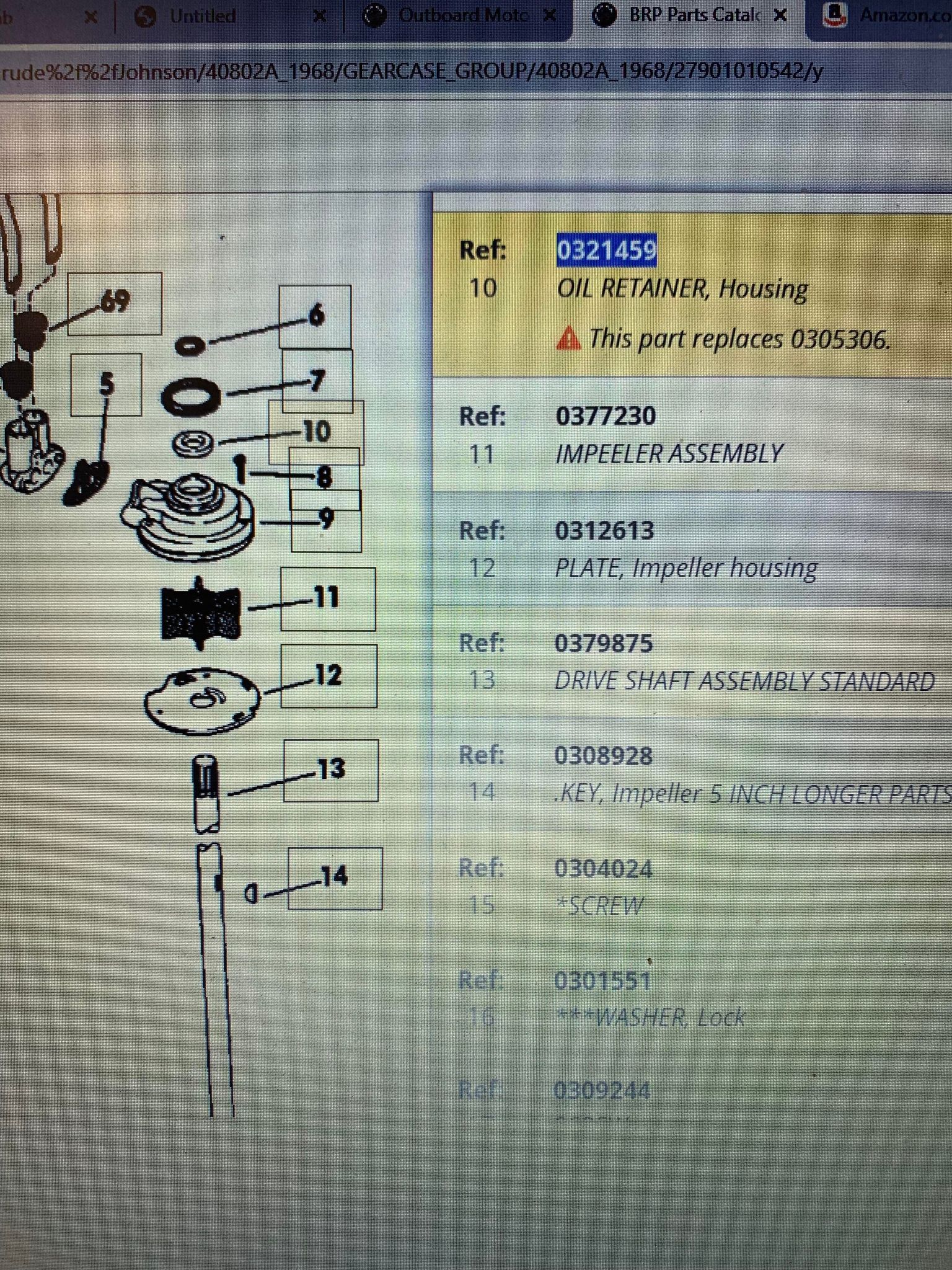

So, I figured out my problem. I had a bad seal on my impeller housing, and I guess it was just sucking air and would not pump. Also, the housing may have been warped a little bit.
I figured this out by running the engine in the pond with the thermostat pulled, and a screw driver pushing the check ball down. All I was getting was hot air. I ended up buying that $40 Johnson and swapping the housing, seals and impeller over. I made about 10 laps around the pond, and the temp gun never said over 120 degrees. The seal is part number 10 in the diagram.
