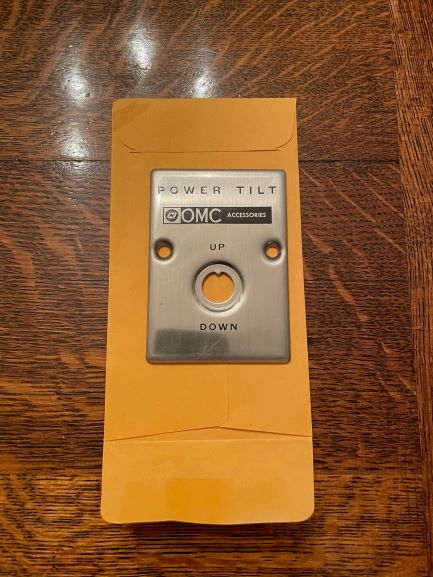

I also scored a nifty NOS tilt switch plate that will look great on my Seafair's helm.
