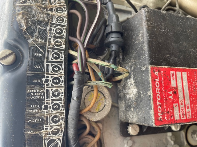

In November, I bought a "new to me" '72 Fabuglas Trident Mark II with a '72 Evinrude Starflite 85hp outboard. I am quite new to owning a boat and have absolutely no real information about this boat/engine. What I do know is that it was run last summer. When I got it home, I winterized everything. The engine turned over (starter works and not bound up) and there was no water in the gear oil.
--Issues and Questions--
When I went to hit the wires with anti-corrosion spray, I noticed that the wires coming out of the amplifier assembly (power pack?) are all fairly cracked and have exposed wiring (picture attached). There is also a wire that goes from teh amplifier to the stator that is cracked like these (I couldn't get a good picture) I understand this item can be somewhat costly and difficult to locate. Should I just cover these with heat shrink or liquid electrical tape? I really don't want to dump a bunch of money into this thing until I know how well it will work and how much I will actually enjoy boating (never really done it).

'72 Evinrude Starflite 85hp (85293R) 5 years 6 months ago #144395
Absolutely replace the pump. A pump failure can and will take out the powerhead in under a minute if running on plane when it goes.
You have not mentioned checking spark. That needs to be done as well as a compression check.
Spark can be checked with the plugs out of the heads and while doing a compression check.
Heat shrink and/or liquid tape can be used on the wires until the need for replacement is determined.
