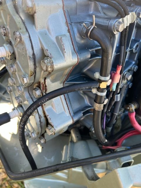

Simple overboard water indicator 3 years 8 months ago #147695
  • Pappy
  • Pappy's Avatar Topic Author
  • Junior Boarder
  • Junior Boarder
  • Posts: 149
  • Thank you received: 22
Eperot - Here is the picture I promised you. This is by far the easiest way.
I got rid of the white tie-wraps! Did not have black over at the warehouse.
Note that this is on the Evinrude that had the reed issue. I went through that engine and updated a ton of stuff before putting it back together. It is now back on the G3 again and doing well.
