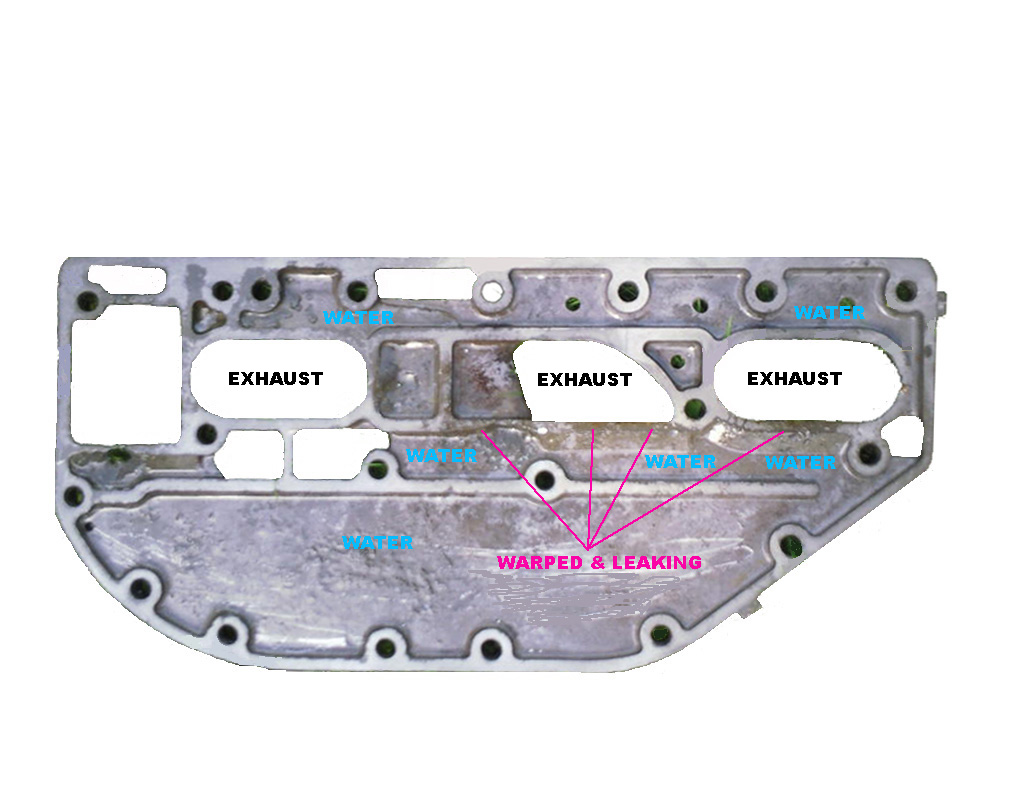

I had one of those motors a while ago . Same problem no power under load. I found that it burnt a hole through a plate that separates water from exhaust , I found a new piece and replaced it and regained power. I noticed paint was burnt of the side of motor where exhaust runs down to lower unit. Three mechanics looked it over and could not solve problem . So I took a shot and that was what I found

Based on much experience, I say that motor is ingesting water into the cylinders. They are notorious for that. It is a warped baffle plate in the exhaust covers.
Not meaning to be nasty, but the water usually destroys the powerhead bearings before anybody figures out what is wrong.

Typically when an engine has a leak at the inner exhaust plate the engine will start normally and run until the powerhead fills with water and water pressure then leaks past the warped part and into the cylinders. At that point you drop one or more cylinders and when you pull the plugs you will see water on them and or they will be sparking clean compared to cylinder (s) that are not leaking. That does not take long. You ran much longer than that. You changed plugs.....did they all look the same or close?
