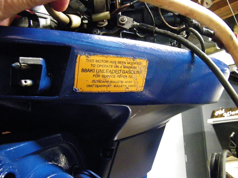

I have my '77 140hp Evinrude up for sale, good running motor with t/t. I had a buyer inquire about the compression and I told him it was mid 70s on all four. He said he'd have to rebuild it and then the "negotiations" began, I wasn't going to sell the farm for one man's opin.
Tried to inform him that this was a factory modified motor for running on E-whatever gas. Even has the factory sticker on it stating that. The modification include lower compression, don't know why but here's an interesting discussion about that issue. For you guys info.
It's a cut and paste and then I'll put in a picture of the sticker that I have on my motor.

The 140 is a "hot" running motor, i.e. exactly as was said, it's ported for higher performance. So a garden-variety, Plane-Jane 85hp (which has the same bore and stroke as the 140) will likely have more cranking compression than the 140.
My good boating buddy had a 1350 (the earlier brother of the 140) and he said the compression was so high that he had trouble getting it cranked over. He put a new starter motor on it, bigger battery, and ran larger battery cables. It would start OK but still cranked slower than you'd expect. The octane requirement for these was very critical, as they would ping on poor gas. Even the gas left sitting in the fuel lines and carbs for extended periods could degrade and cause detonation issues if you didn't idle the engine for a while and use up that old gas.
OMC did put out thicker head gaskets to lower the compression. Quite sure there was a service bulletin about that, too.
