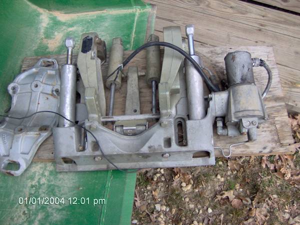

I have a 1972 Johnson Model 65ESL72S . It id not equipped for power trim , it has the hole markings , but the holes in the swivel bracket are not drilled through. How can I go about adding this option to this engine .?. I have found a few $$$ WORM drive units but I am unsure if that is usable on a 72 . I have a few Mercury trim units , But they Just WON'T Work on the JohnnyRude ... And Yes I am Always Looking for another Arkansas Traveler ... The engine pictured is not MINE ! Just a reference that I have used ...

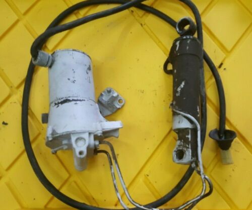

Sorry to be late to the party. I don't think there was actually a TRIM and tilt unit for '72. There is a bolt on tilt unit but I don't know if you can trim out under power with it. I have a TILT unit on my ''76 Johnson that I can share pictures if you want.
couple of options; If you can find an old junk motor with tilt just pull the swap. Sounds far fetched because the tilt for '72 was an option that I suspect not too many people chose.
Craigslist or eBay might have a unit to fit your 72.
Here's a snapshot of the unit for the '72 65hp mounting. Check it out and see if the holes you mention are in the right place.
Hope this helps somewhat.

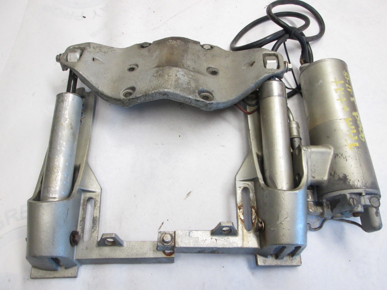

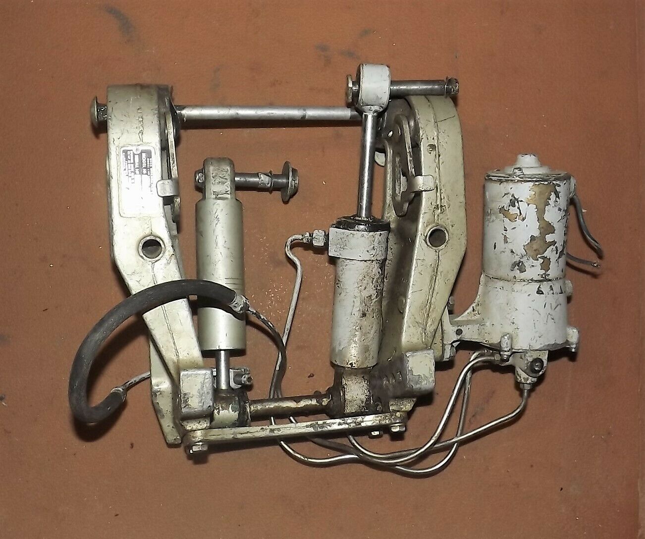

I am in a similar situation. I want to add power trim and tilt to the 1974 Evinrude 70 on my Fabuglas 160.There is information online, tons of part numbers, several used setups available but nothing 100% conclusive about what would have been original and what will definitely work. I guess I could just buy one of each of the 4 styles I have found then sell the ones that don't fit, but it would be better to buy the right one the first time. Any expertise is appreciated. And if anyone has a unit for sale that will fit, definitely contact me. Thanks!
Adding Tilt to a 1972 NON TILT Johnson 5 years 11 months ago #143547
If you have deep pockets buy them. A suggestion would be to go to marineengine.com and find the part number for the t/t for your motor. That way you can be sure without the expense. They have factory schematics and pics of the units for each application.

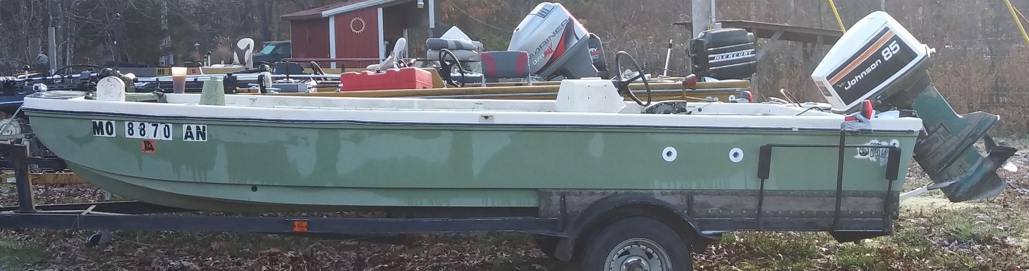

Okay ... So in my everyday search for a Tilt. Or T&T unit for my 1973 - 65 hp Johnson .. I stumbled upon a 1972 BassCat DLX . Complete w/ a 1975 V4 - 85HP Johnson. I bought it Sight Unseen... The tilt trim unit is complete. But I can't see removing it from the V4 engine unless the compression test shows otherwise... I'm happy I found the Factory Complete Boat ... But not sure if I have made progress on the Original Objective lol.....
