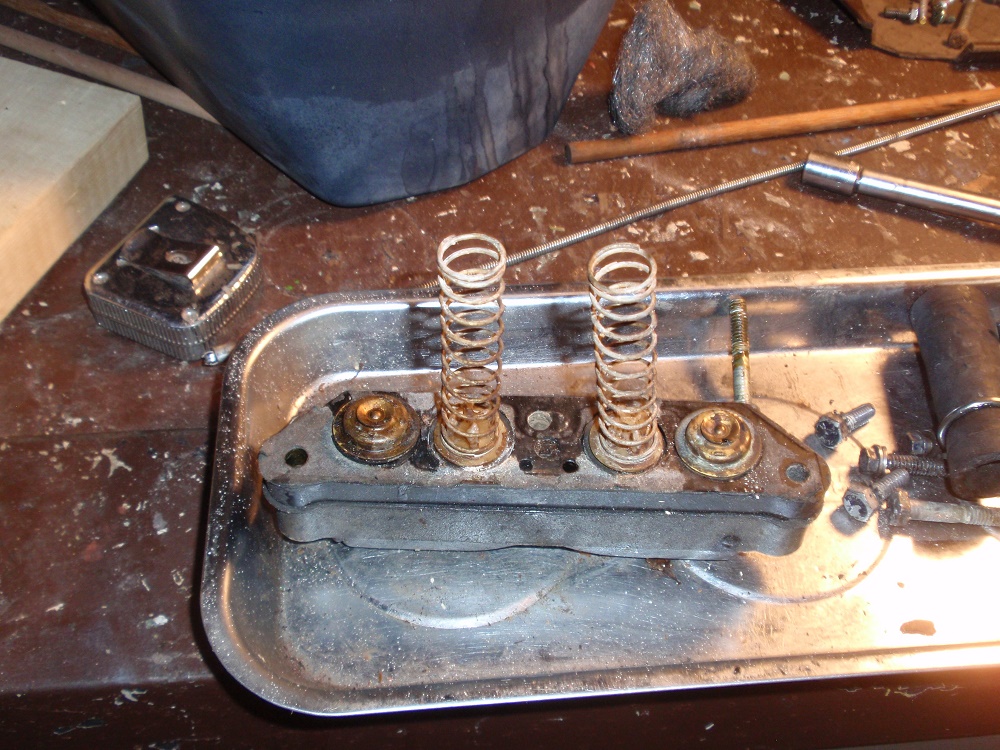

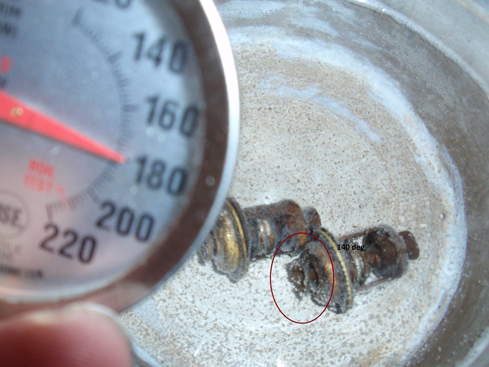

Removed the thermostat housing, the stats were a little gummy so I cooked them. One opened at 140 deg, the other opened around 165 deg. The springs and seals are all good.

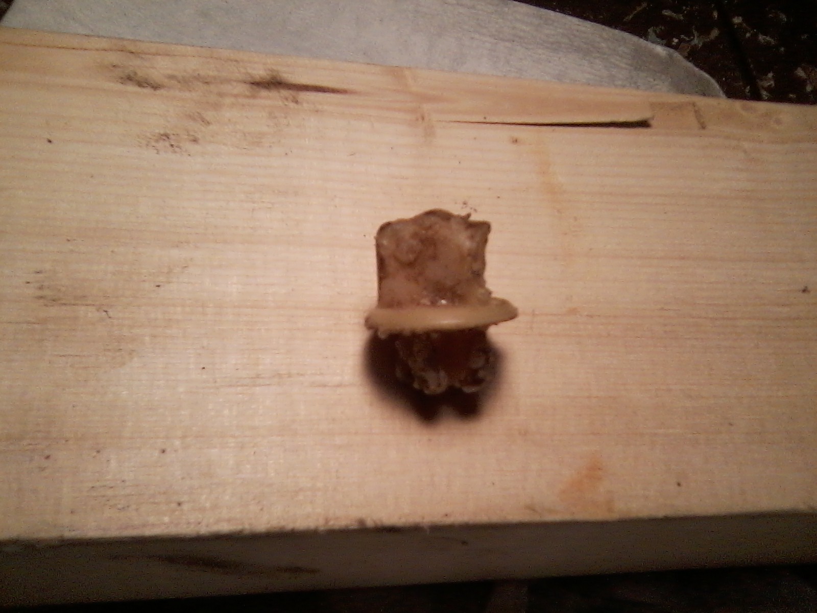

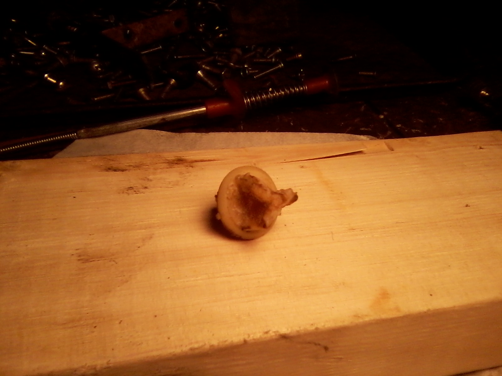

Also mention that one of the plastic plungers looks like it had melted somewhat. It still seals good but what would cause that?

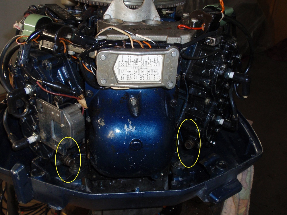

PS> I did drill three large holes in the lower cowl to get to the thermostat housing bolts :-)

I found some blocked passages in the thermostat housing. Two small holes that I suspect were air bleed were plugged up.
Installed two new thermostats and backflushed the pump and heads. The discharge hole from the stats was also gunked up. New gaskets etc. Started it up and a few seconds water was flowing :-)

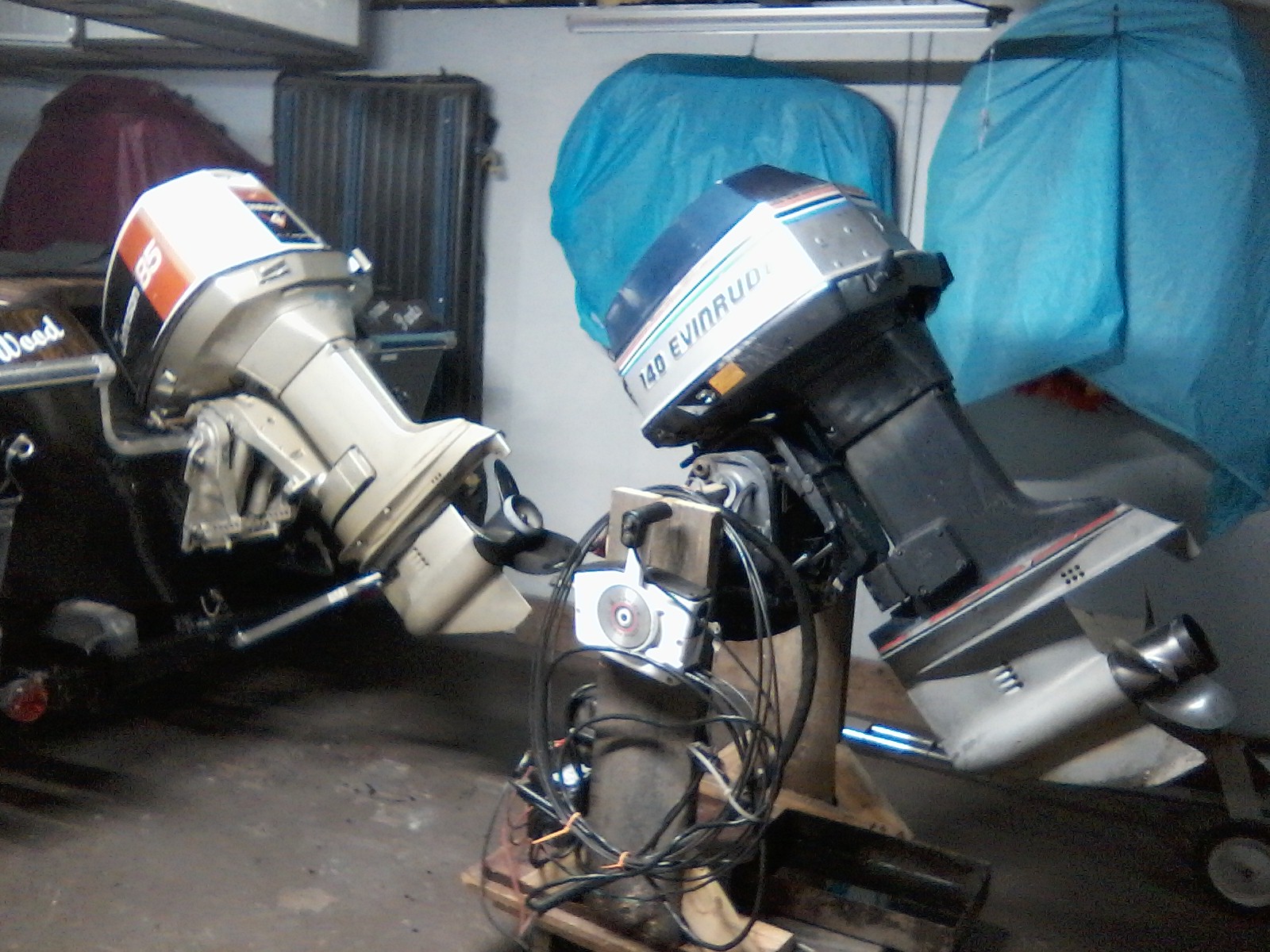

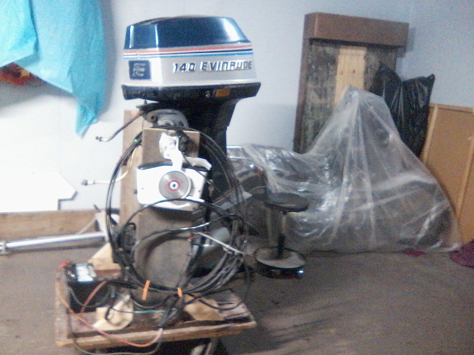

Hey Cal what's the weight on that 140? It really doesn't look like it could weigh more than my '67 85hp. My Wagemaker is rated for 100hp but I'm sure that's due to the weight of a 100hp at the time vice actual hp. I've been afraid to try and put anything bigger than an 85 on there due to the weight. The transom is still original and don't know how much it can take. The plywood is bone dry but Dad said he thought it was shot, didn't look like that to me.
So anyway, I wanted more than 23 mph wot with the '59 fat fifty on it hence the '67 85 hidden in the '61 housing. The 85 definitely isn't at it's peak compression, I think when I first got it, it was 90/95. I haven't run it in a year and half so not sure what it's at now. Been running Seafoam in every tank since I did all that switching. I could do a rebuild maybe to bring it back but I figured a much newer model would be more efficient and still get some more mph out of her.
Cooling discharge? 6 years 7 months ago #141959
Specs say the 140 is 326# and the 85 is 270#. I suspect the 85 is somewhat heavier than that. If you look at the pictures you can see that the 140 LU is quite a bit beefier, larger supports, gearcase, et al. Don't know how much and extra 50# would affect performance.
