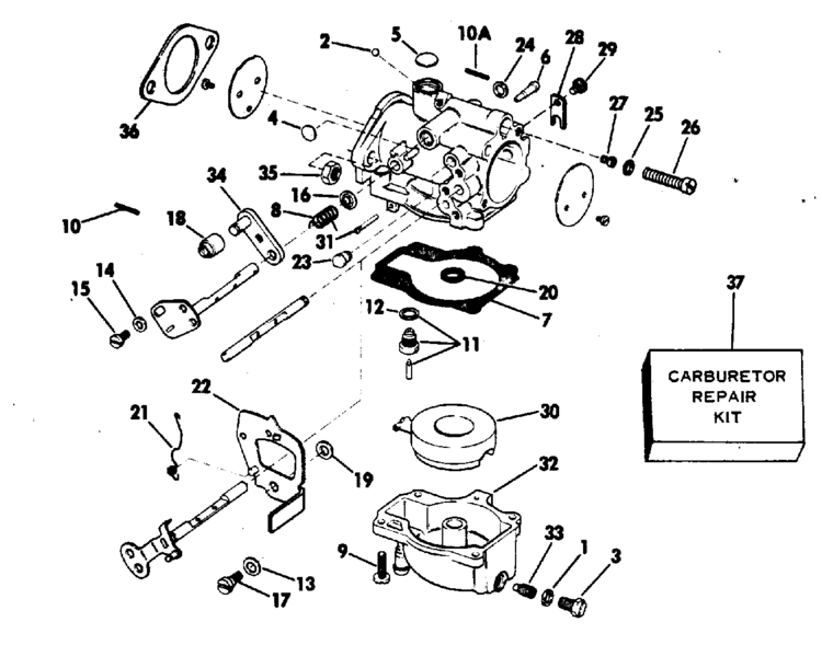

1978 70hp Evinrude. Has a low speed miss, idle, no wake. High speed is a rocket. I don't know which of the three cylinder is the problem. Changed plugs, check all the coil wires and connections. Is there a low speed jet on this thing? Anything that can be blown out with carb cleaner or air? How about just changing all the coil wires in case one of them is bad. Wondering if solid core would be better than the carbon cores that are on their now.
Running idle miss 7 years 5 months ago #139678
No idle mixture, #27 is an idle air bleed. Smaller bleed = richer & of course opposite too.
