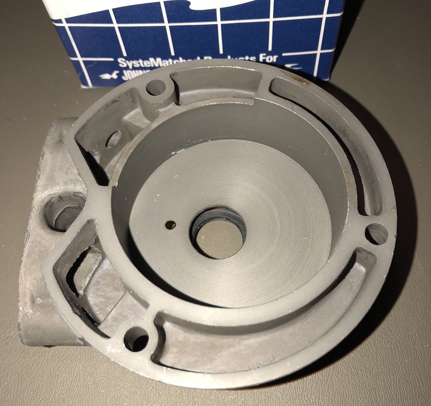

No longer available ? No can find ! ! 1959 Johnson 35.Horse. Any Ideas ?

Well, Marineengine.com has 2 of 'em in stock for only around $188 each!
www.marineengine.com/newparts/part_details.php?pnum=OMC0378348
I wonder if this late-60's 40hp pump from ebay could be adapted to fit:
https://www. ebay .com/itm/USED-JOHNSON-EVINRUDE-OMC-381576-IMPELLER-HOUSING-NO-SEAL-1968-1970-40HP/272263838401?epid=1126254539&hash=item3f64307ac1:g:5JwAAOSwARZXjQJd
From what I recall, the later 40hp motors had a different (thicker) impeller but I don't see why it wouldn't work. Check the pump housing bolt pattern and see if it's the same as yours.
late-60's 40hp impeller: www.marineengine.com/newparts/part_details.php?pnum=OMC0777213
Note you'll have to copy the above eBay link and then take out the spaces, this site parses any eBay links.
HTH............ed

Well, I looked up the impeller for your '59 35hp and it's the same. So the only critical difference might be the pump mounting holes. If that's the same on the 40hp as for your 35, I don't see any reason why the 40hp pump wouldn't fit.
Big Twin Gurus pls feel free to chime in!
0378348 OEM part .. 8 years 2 months ago #137326
  • ed-mc
  • Posts: 1482
  • Karma: 235
  • Thank you received: 131
40hp housing, less the water tube fitting, looks very similar to the 35hp:
www.marineengine.com/newparts/part_details.php?pnum=OMC0381576
Here's a 40hp pump housing, Brand New, for only $17.95 shipped:
https://www. ebay .com/itm/New-0381576-381576-OEM-OMC-Johnson-Evinrude-Impeller-Housing-and-Seal/253583825391?epid=1337786261&hash=item3b0ac619ef:g:6NYAAOSwns1a4Kkv
Hard to do much better than that!

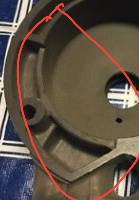

The 40 hp one looks like it's the right one but not 100% sure ... The inside of mine has what looks like a broken edge in the impeller cup.. The one on eBay described as NOS.. Is the same as what I have .... The $187. One don't show the bottom side ... So now I'm questioning if mine is broke or just made that way.... I don't have a picture of my part . but it looks the same as this eBay part . But mine has sharp edges which look dangerous to the impeller...

DLB68 wrote: The 40 hp one looks like it's the right one but not 100% sure ... The inside of mine has what looks like a broken edge in the impeller cup.. The one on eBay described as NOS.. Is the same as what I have .... The $187. One don't show the bottom side ... So now I'm questioning if mine is broke or just made that way.... I don't have a picture of my part . but it looks the same as this eBay part . But mine has sharp edges which look dangerous to the impeller...
I wouldn't worry about that cutout, it's the way they are designed to work. Keep in mind that once the motor is at speed, the impeller blades curl up and act as a circulating pump; they barely "kiss" the sides of the pump.
At any rate, that new 40hp pump is purty cheep so not much to risk by picking that one up. OMC changed very little on these so I expect it'll probably work for your 35hp as well.
BTW you can smooth/sand out any rough edges that you think might catch a blade. Take a look at this eBay pump, the casting isn't exactly the cleanest you've ever seen, they tend to be a bit rough; but generally are machined properly where they need to be.

Many Thanks to the great responses. The cutout on the housing is obviously a manufacturing design , I will use a dremel and clean up the jagged edges on the one I have. The impeller that came out of it ,was missing 2 ends. The rest where ate up on the end and one was backwards. Upon installation I am sure...Please forgive me .. I was born into the Mercury blood line .. If it ain't a Merc.... It ain't right.... Was what I was told growing up... Now I am approaching 50 an Venturing into the unknown...

Spin the impeller into a lubricated pump body and it'll be easier to install. Then you just drop the pump right down so the drive key lines up with the slot in the impeller.
Use some Permatex No. 3 Aviation-Type gasket dressing, or the OMC equivalent, or Loctite 518 anaerobic sealer, on the pump's sealing surface. This will ensure good pumping action.
When you spin the impeller into the housing, remember that you're looking at it upside down, and you should turn the impeller CCW as it goes in the pump. This ensures that the blades will be rotating in the correct direction (clockwise) as the engine turns over. Lube the pump with a thin coating of Vaseline or marine bearing grease.
HTH.........ed
