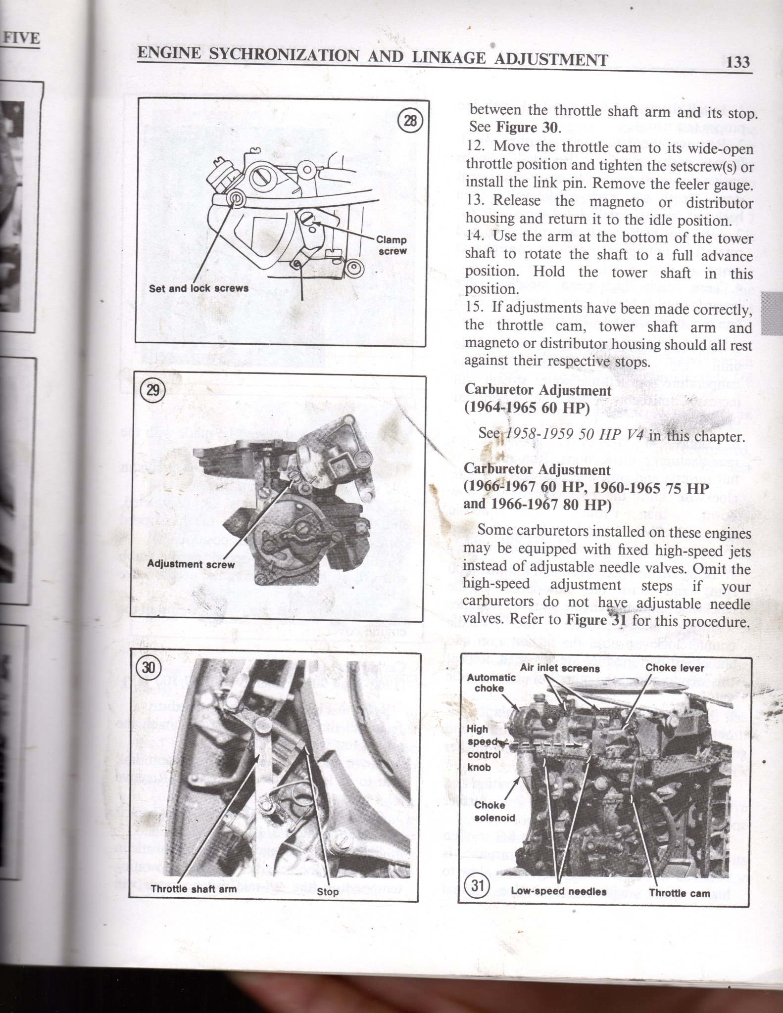

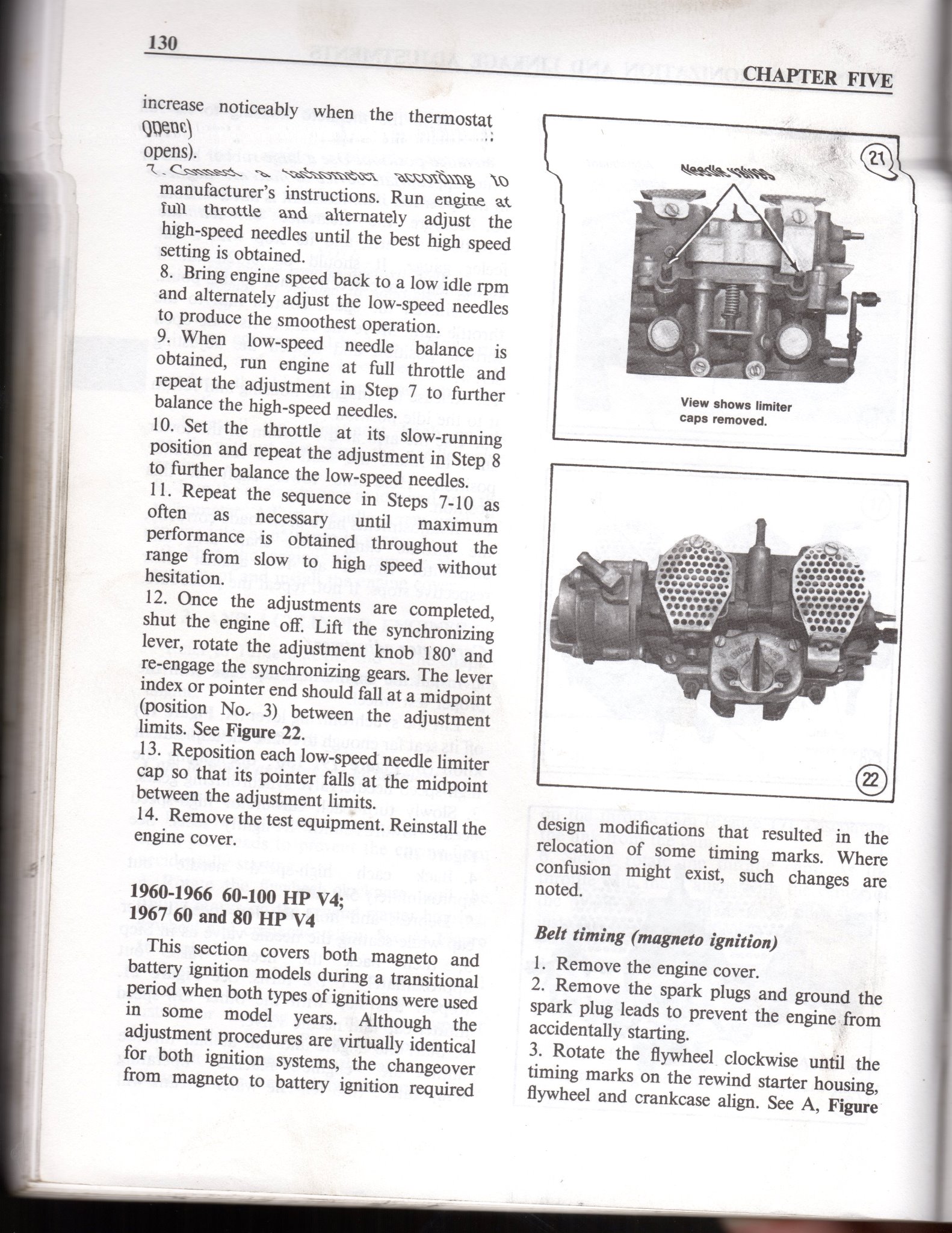

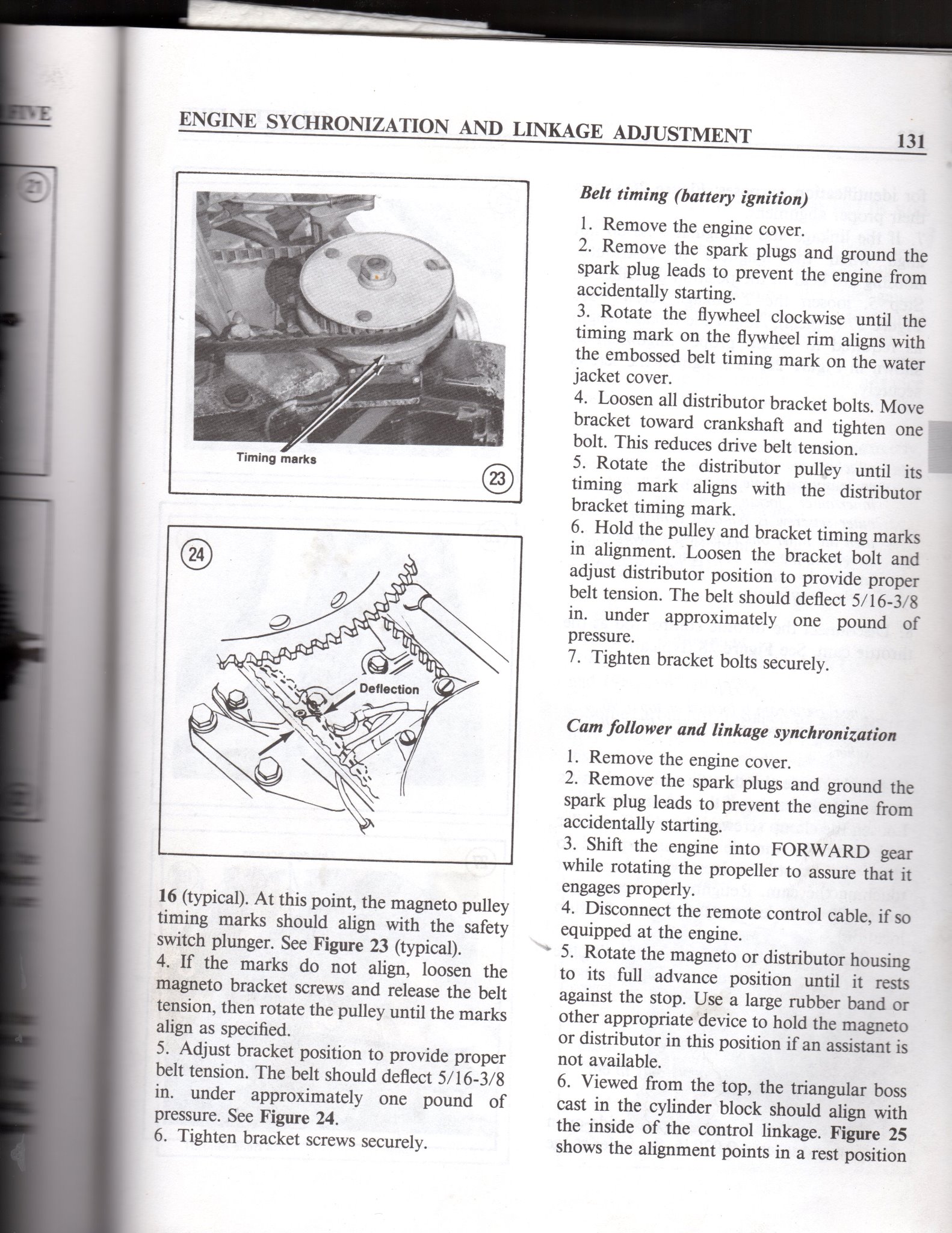

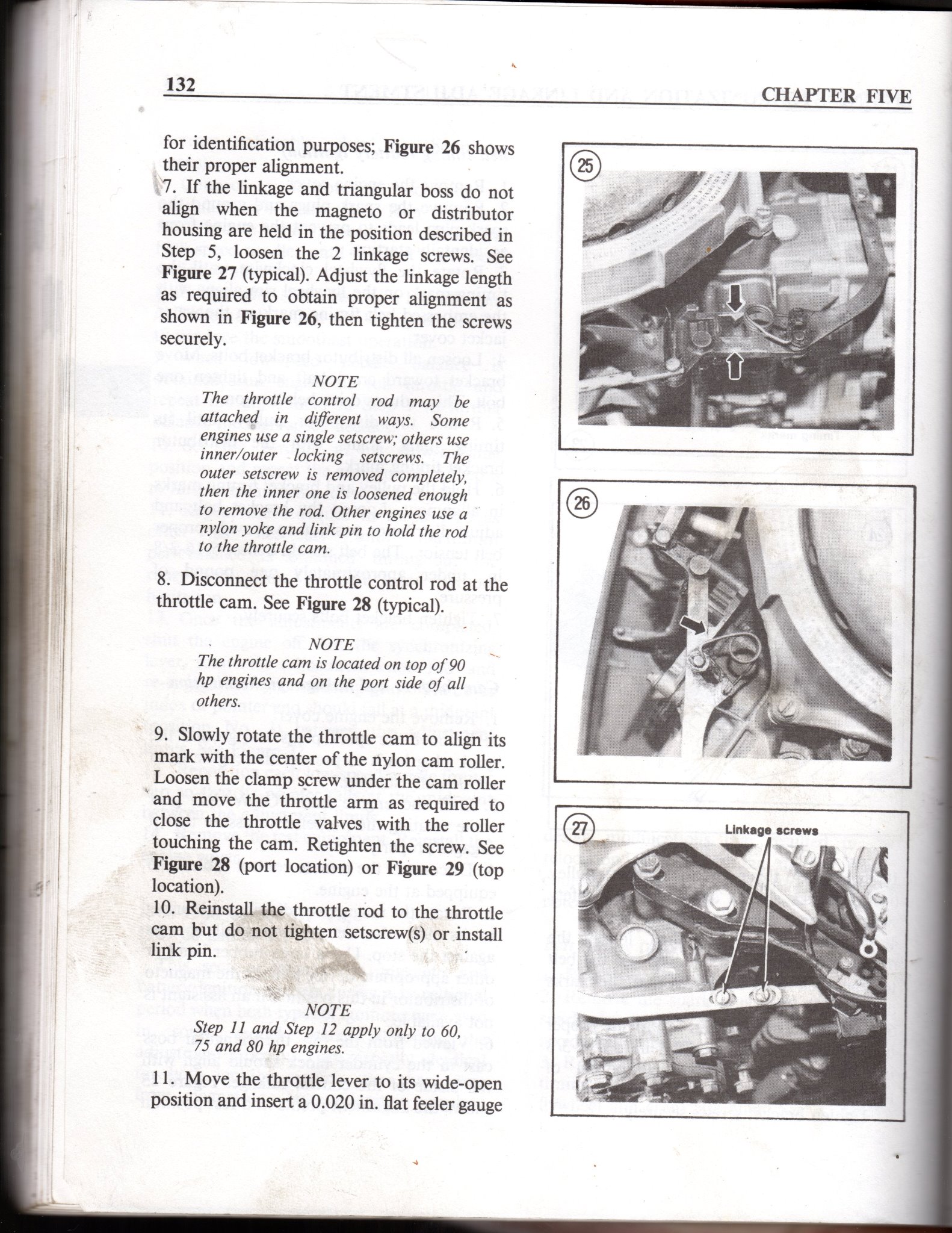

Looking for timing hints 8 years 3 months ago #137132
I know some of ya guys are not big fans of Clymer books but this one has been my bible for a whole bunch of years.
Here are the basic steps for synchronizing your 100hp V4 1966.
Hope this helps with the problem.
Cal

I was able to pull up on an a slalom ski so it isn't horrible. but. it is not as solid as it was. I will follow the directions and see where i end up. I didn't want to mess with it when it was running well.
