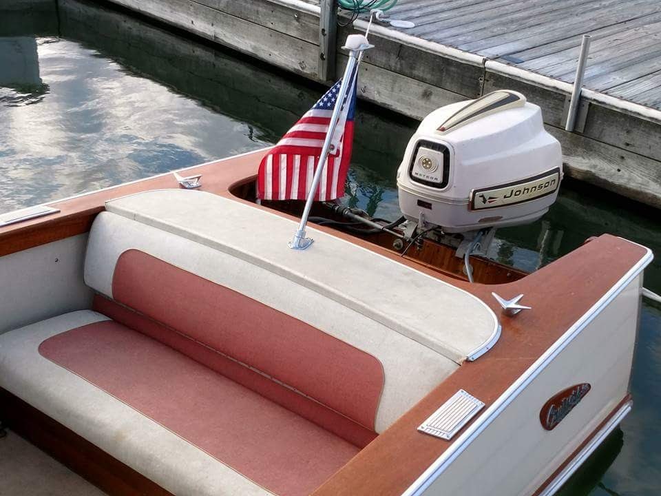

I've been running a 90 Johnson golden meteor for the past year with no problems. This last weekend it started poping and spitting and stalling at idle. It still runs great at speed but when i slow down to come to the dock it will start to stumble and die. Then she will not restart, if i leave it sit for a few hours it will start back up. Im at a loss at what to look at. I only run ethanol free fuel, new fuel tanks and lines. Rebuilt fuel pump, plugs, and points. Whats next?
