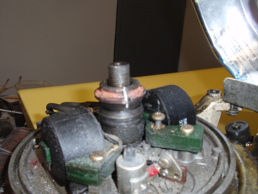

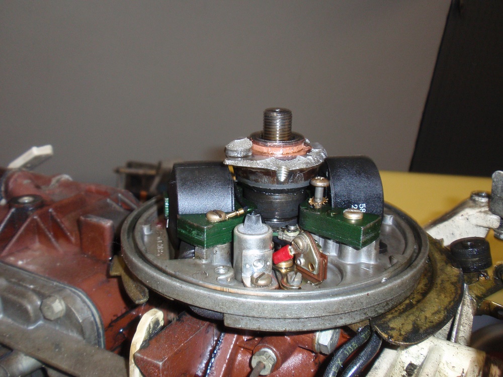

There was a reason I didn't run the lake at Kosh this past weekend, the '58 Johnson RDS20 just wasn't running right, anyone with any experience knows the feeling, something is just wrong.

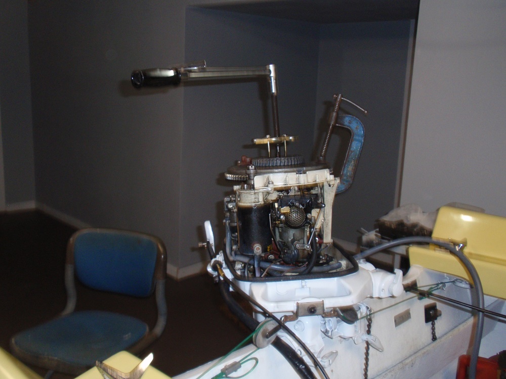

So today I pulled the top to change coils and points, well...sorta. Got ready to pull the top off, I use my torque wrench to pull the cap so I know the ft. lbs. when she's about ready to ping.
Pulled about 60 ft. lbs. and let it sit for about 20 minutes to work, put some more torque on the wrench and it never went over 60. Did this over about 5 hours, a little at a time and still never got over 60. Something goofy here so I just started pulling on the wrench and the cap is coming up real slow but stiff. Finally raised it off by hand only to find that the cap separated from the center, metal just broke apart.

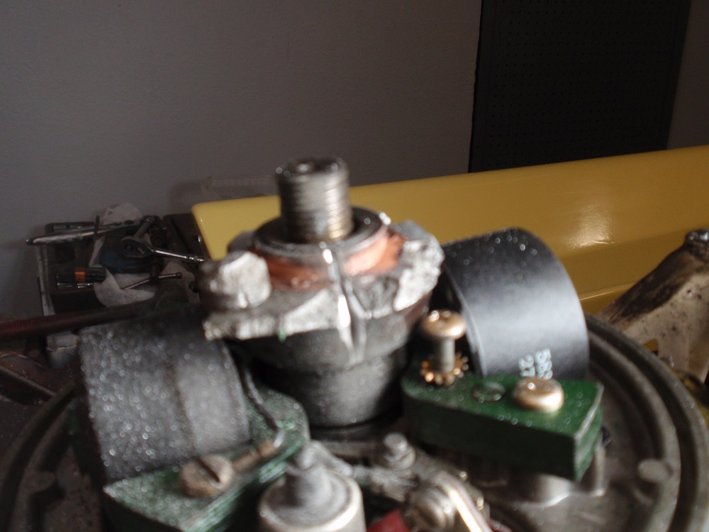

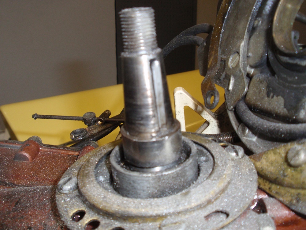

Looking at it I see some PO modified it somehow, tapped and threaded holes for some reason and really weaken the area. So now I have a problem, the center of the cap is solid on the crankshaft and no way to pull it off. I decided to take the Dremel and cut a slot to weaken it.
Got the rest of the soft stuff off and now the hardened steel inner (race?) was cutting through and then the 35 year old Dremel went kapoot. Go figure! Have to visit Harbor Freight to pick up a $25 special to finish the job. I do have a spare cap for this puppy. If you look you can see that the PO or whoever worked on it didn't even tighten down the coil screws.
Thinking someone might have used locktite on the crank.

I wish it was just a sheared key. Today I pull off the coils et al and cut off the scrap metal. Good learning experience for anyone else here.

Checked the point gaps through that little hole and everything was good, fuel delivery good also. Pulled the flywheel to find that the wheel spun on the crank. Sheared the key. Guess I should have expected that since the old wheel was cracked and whacked. The old key was "welded" into the keyway. Took hours to drill and punch it out, harbor freight rotary tool back to the rescue. Found another key on eBay.

Be sure you "lap in" the replacement flywheel to the crankshaft taper. I would use fine valve grinding compound for that task. The crankshaft taper must be perfectly smooth to seat against the internal taper of the flywheel. Any material welded-onto the crankshaft from the old flywheel is unacceptable. Otherwise it'll continue to shear flywheel keys.
You should be able to pick up some valve lapping compound (i.e. "Clover" brand or equivalent) at most auto parts stores.

Last thought, the crankshaft and flywheel must be dry and oil-free before mounting. Use no grease or oil on the tapered surface.

Note, I did pick up a tube of lapping compound from AutoZone, the Permatex stuff. Never used it before so didn't know what to expect. First surprise was when I used the cap to puncture the seal on the tube,...gusher....didn't expect it to be so thin. Smeared some on the crank and then put the flywheel on, spun it back and forth, around in circles etc. you can feel it getting clean. Cleaned it all up with a damp cloth and compressed air. Now that wheel seems to sit tight and lower, can turn it on the shaft without any binding at all. :cheer:

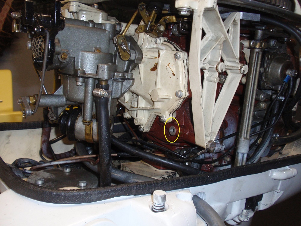

Ed. need some more advice. Put the motor in water today and it starts right up but could not adjust the idle. Two things which puzzle me. 1st. there is a small hole on the front of the block that leads directly into the crankcase. This thing is wide open and when idling (roughly) it spits out unburned fuel and exhaust. Really spits when it chugs. I looked at my parts Gale motor and this hole is plugged. I 'm thinking that this hole should not be open. OPIN?
2nd. the rod that connects the carb throttle lever to the spark advance was moved and I wondering if that should be contacting the advance lever at the same time the throttle is in the start position and the little cam follower wheel is lined up with the brass plate mark.
Thanks.
What else can happen?? 8 years 4 months ago #136803
Problem solved! Tried plugging the hole and got a backfire that just about blew my garage door off.
I tapped the hole and ran a copper vent tube to the drop leg Re adjusted the carb link to the timing advance and now she runs like a baby.

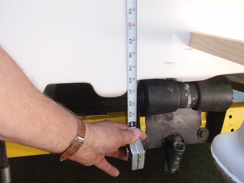

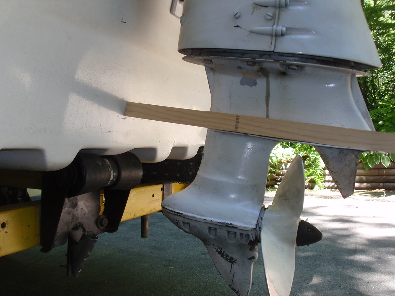

Got the motor running satisfactory, not perfect but OK for now. Nother problem crops up. Motor revving like crazy but not going very fast. At first I thought I had a spun prop. changed it and same thing, went to a third prop and same thing. No way could I possibly have three bad props so there has to be another explanation. Got back on the trailer and headed home, took some measurements on the transom. 20" for a long shaft, motor prop was not engaging deep enough in the water and was cavitating. Couldn't see that while driving. Started cutting 5" out of the transom @ 1pm. 3:30pm finished.
Pictures not in order but now I have a 15" transom. Saved the "plug" I removed just in case I want to swap motors in the future and add the extra 5" back.
