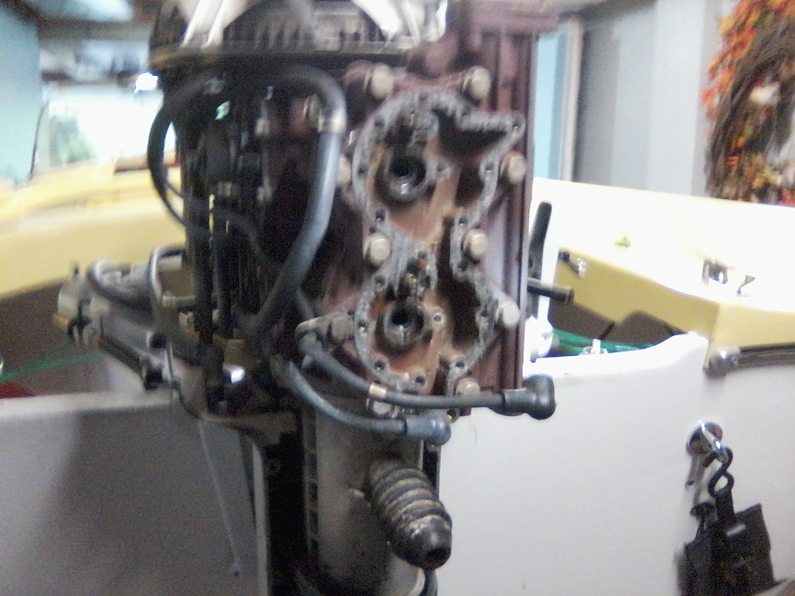

I know I should post this on the JEGO thread but I'll get more looks here. '58 Johnson rds20. put in new water impeller and a new thermostat but still not getting any cooling water out the exhaust and it runs hot. I pulled the cap off the thermostat and ran the motor and was getting exhaust out the feed hole but no water. Motor ran great but of course I shut it down. Opins?? The pipes from the impeller are all in correctly but wondering also if the connections to the powerhead might be bad. When I blow compressed air through the water inlet hole the air comes out the exhaust. When I blow air through the poppet valve the air comes out somewhere under the shroud.

Ed. I shoved a hose up the tubes and got water out of the large hole where the poppet is. I dropped the LU again for the 6th time just to check again. All tubes are installed and fitted right, the rubber grommets are tight. Shifting works I put it in gear while the motor was running before it got too hot. I sunk the LU in a tub of water and spun the drive shaft with a drill and it pumped. I just pulled the cooling cover off and it was bone dry! Something is wrong somewhere. Never worked on a two pipe system before but I traced the tubes to find that the drop pipe on the port side is just blanked off at the impeller, goes nowhere. I'm thinking of swapping out to a single pipe and just plugging the other side.
Does the water flow up from the bottom through the cyl jacket and then out the top? Thinking of putting the LU from my Gale on there. I know that pumped good but it does have the single pipe

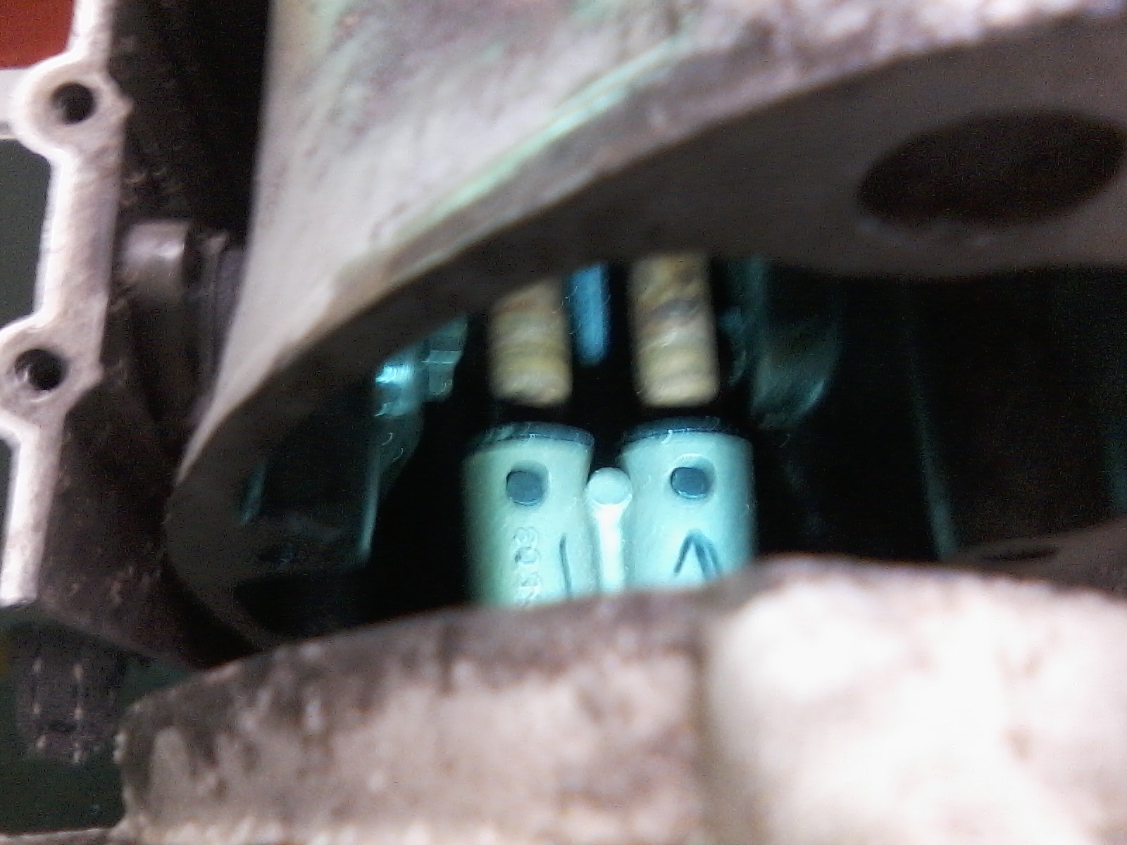

O-Kay....Did some more futzin' and here's what I did.
1. Made a new gasket for the upper cooling plate.

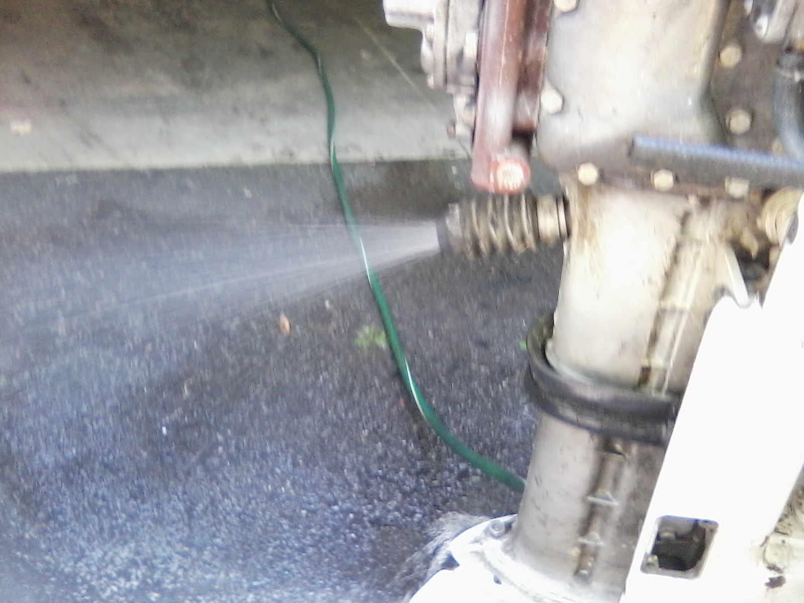

2. Ran a hose directly up the shoot and plugged the outlet to flush the system again and find out where the water flows.
3. Installed the cooling cover, devil of a time getting those compression relief springs back in place.
4. Ran the motor and water did flow through the entire system, did not run "cool" but I could keep my hand on the cylinder walls.

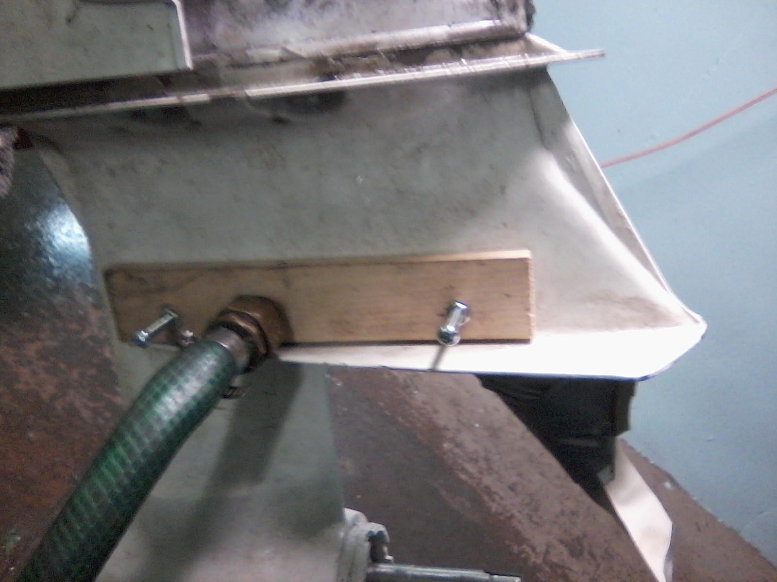

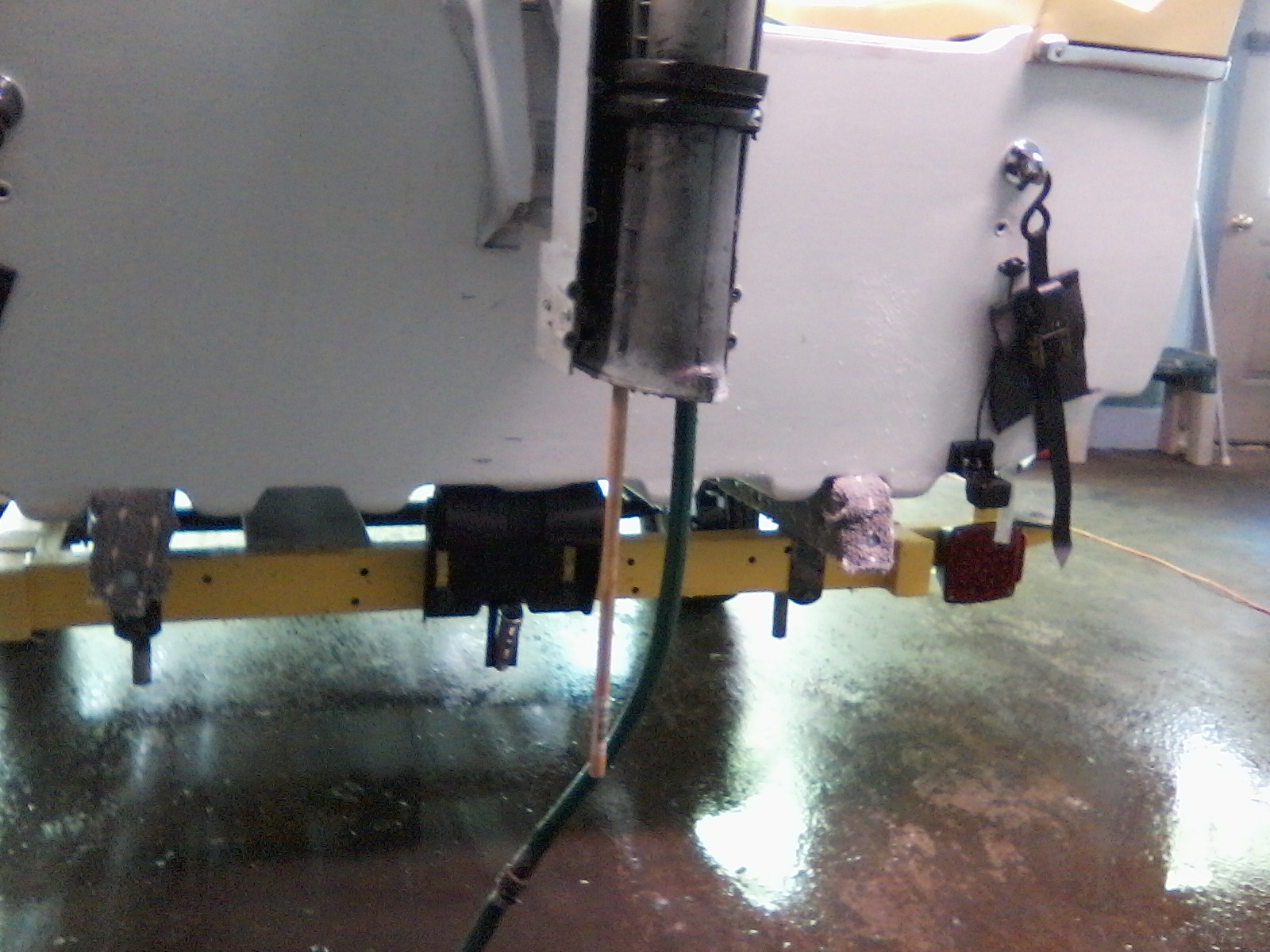

5. Re-installed the LU and made sure everything was correct.
6. Put on my handy dandy hose attachment.

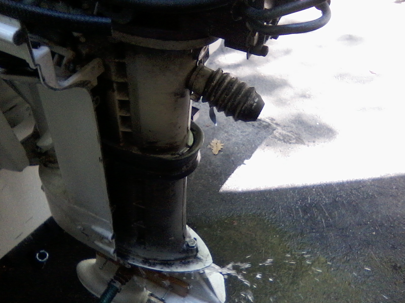

7. Started ii up again, water flowed through the pump with the hose, thermostat functioned right.
Before thermostat opened.
You can see the difference in water flow out the exhaust.

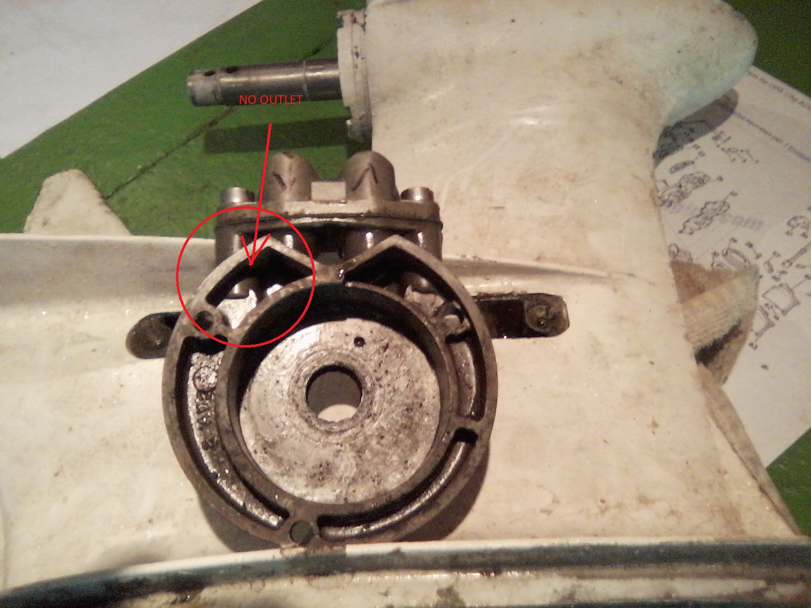

The impeller housing showing that that "return" tube is totally blocked off.
One major thing I did find is that the impeller housing was not square on the bottom, had to mill it flush. A clue was probably when I originally pulled the pump apart the PO did not have the shaft seal in place and it was cocked on the driveshaft, Guessing he bent the housing when he put it back together.
Temp outside is now 95deg and humid, time for a cold one. Can't really dunk the motor in the water until next Tuesday. Boat ramp is full of crazies this holiday weekend. Besides my workroom looks like a tornado went through it while doing this dirty work.
