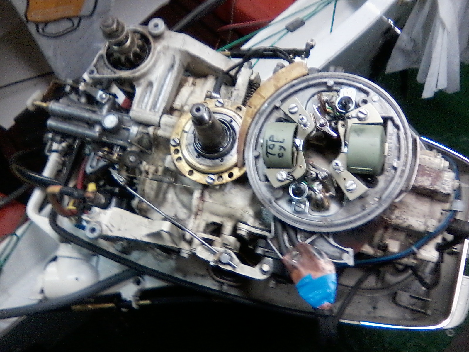

Put in new coils, plug wires, points, coils, condensers, figure this thing should start and run like a top. NOT!!!
I've done this all before on different motors but never ran into this problem. Motor turns over great, after a few seconds there will be one loud backfire. BANG! Timing problem but as far as I can see it's all done by the book.
Each point set at .020 high side of cam. Tried swapping plug wires thinking I had wired the coils a$$$backwards but then I get nothing at all. The back fire tells me I have spark and fuel.
Any advice?
Maybe there is a sync problem??

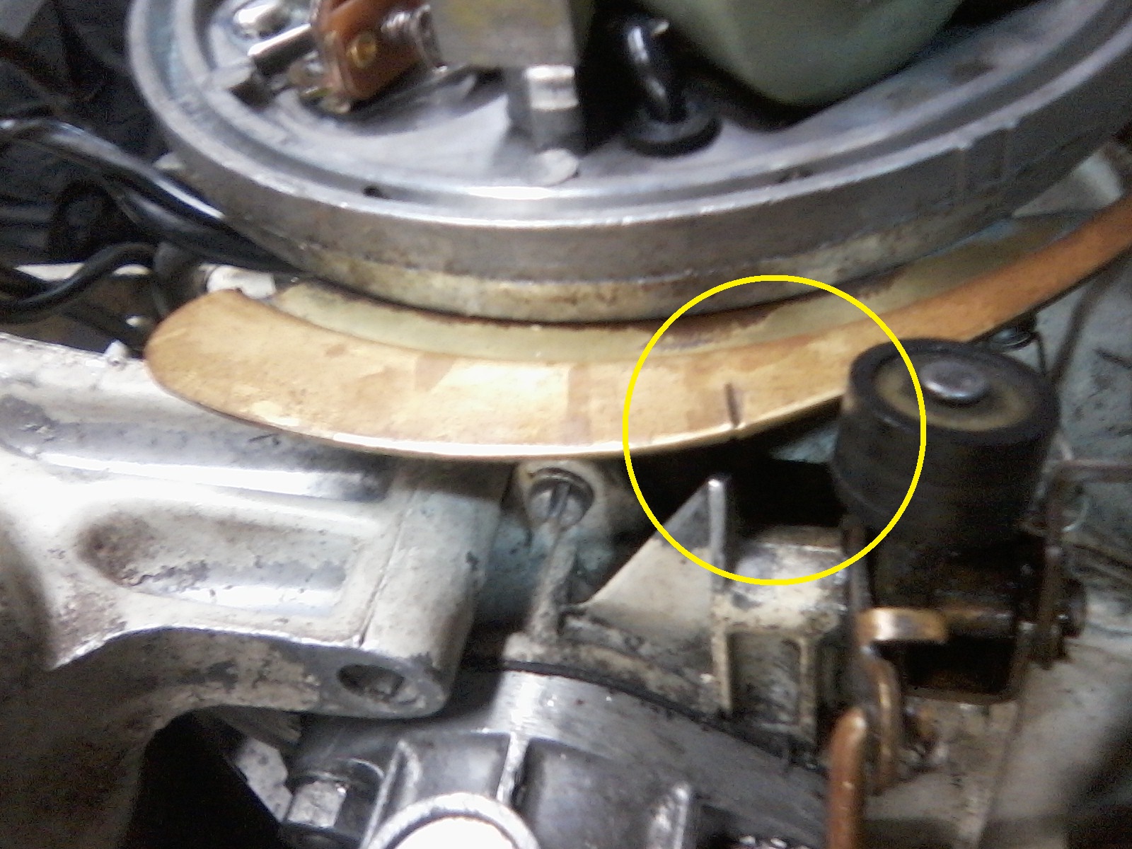

One question that would make a big difference. Does the plate index mark have to be lined up with the index point on the case? I've seen some youtube vids that say to line up with the wheel, not the marker. I've been setting the points with the throttle at the slow stop. Probably why I get the backfire. fuel going into the cylinder but the plug not firing until the piston is past the exhaust port. Just so I'm clear on the principle I put the old dowel stick in the top cylinder, reached TDC, then set the points so they open (field collapses) at the reference mark.
need expert help 8 years 6 months ago #136235
Your points are set at .020" when at the high point of the points cam. This can be accomplished by slowly turning the motor over or moving the mag plate until the the points are fully open.
The timing mark on the brass throttle cam is used to synchronise the throttle opening. The butterfly in the crb should just be starting to open when the mark is lined up with the pointer cast into the block.

A problem I have now is that I"m only getting spark on #1. I pulled the top plate again, checked all the connections, checked coil primary and secondary, all checked out. Wires are good. Good readings from the coil to the plug terminal end. Points are polished.
There are three wires going to the points. One from the condenser (black) another from the coil (green) and another black wire from the vacuum cutout on #2 (the one not sparking) magnito cutout is on #!.
Reminder this is a 1960 40hp Gale (OMC) electric start.
