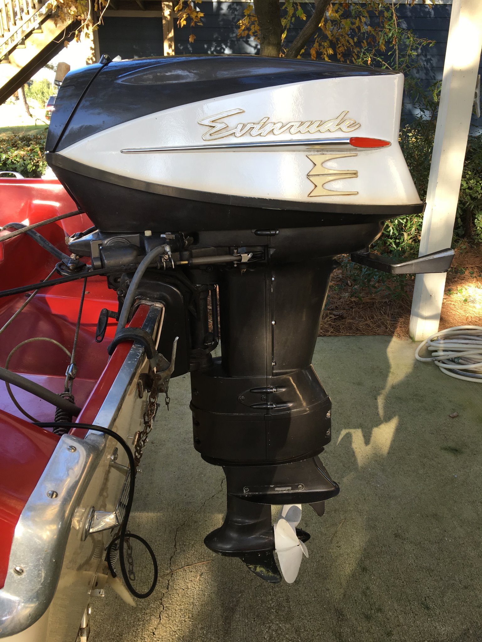

i have a Lark lll that I think needs to have the screen changed

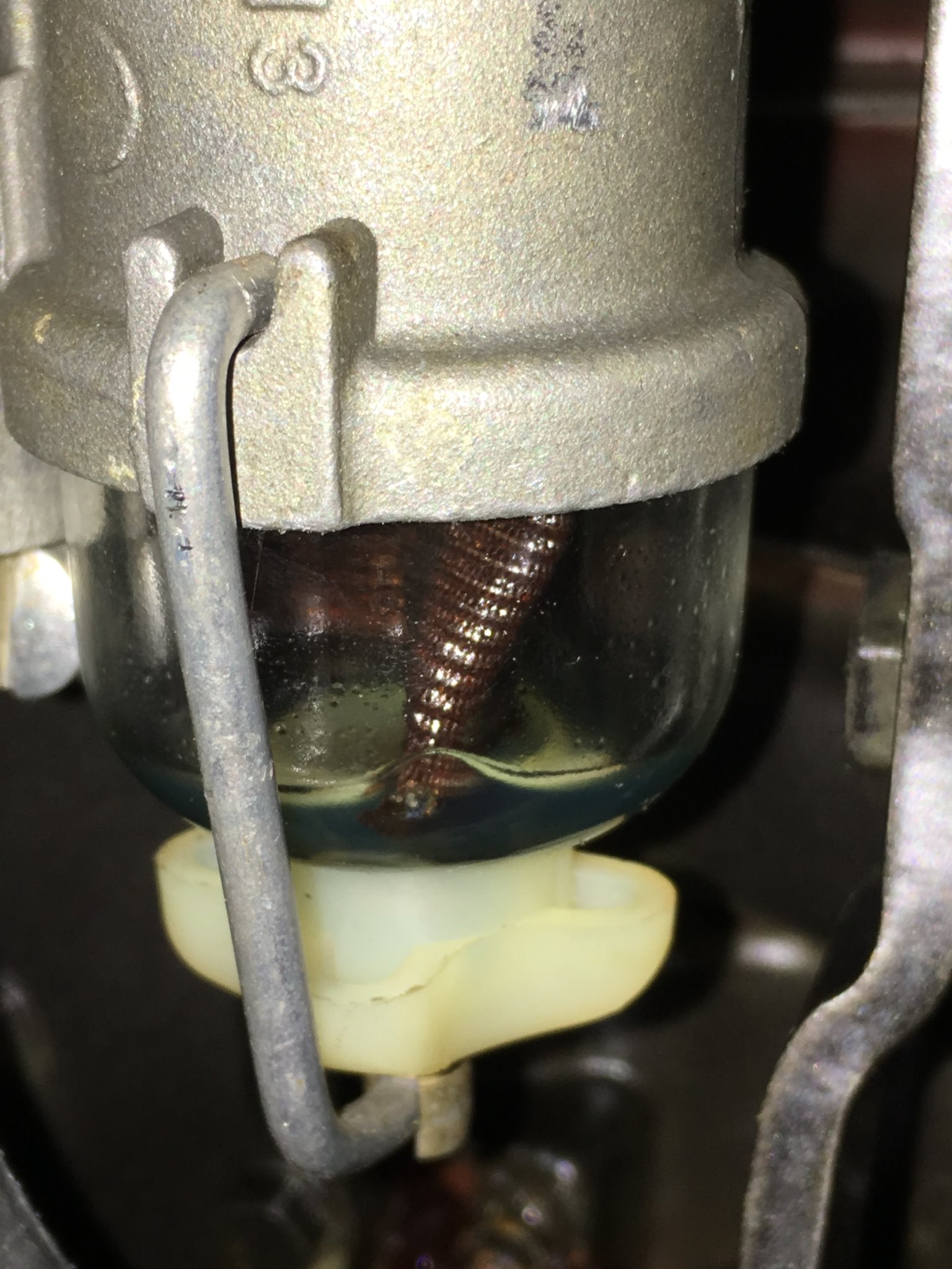

in the glass bowl on the carb its very flat,and discolored, is this normal? Ran it last season
and at the end of a small cruse in a no wake area I lost power in engine.
coasting to dock. engine would crank but wouldn't start, 1/2 hr later it fires up
and made it back to launch. where can I buy this screen for this 2 stroke bowl,
note, my fuel lines and supply are new. thanks guys

In the first pic, there is some white gunk in the bowl. Did you maybe get a little water in the fuel?

will flush system, bottom of bowl white is reflection of white screw,
the glass sides of bowl may have something on it,
thanks
Evinrude 61 Lark lll engine question 8 years 7 months ago #135908
Yeah, I see that now. I have an old '59 35hp and I tried to get that screen out of it but it sort of fell apart on me. It's basically just a strainer more than a filter. Good luck with it.
