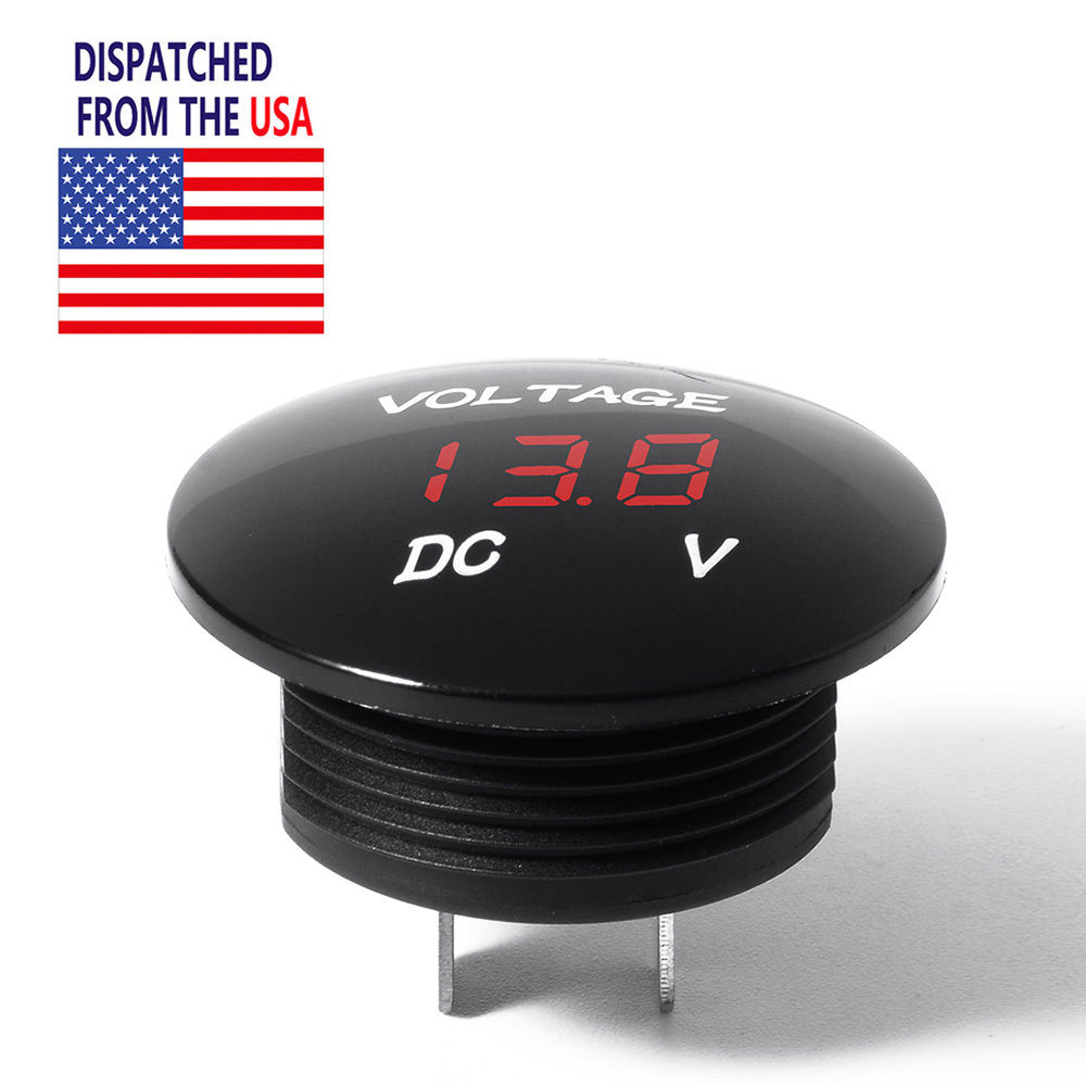

I know this is over simplified but as long as you're going to invest in a second battery get yourself a good deep cycle. Put it in your battery box alongside the main battery so that you can switch wires if needed. I have a separate wire system for all the extras, depth finder, radio, lights, etc. I run +/- wires from the extra batt to a buss bar under the dash and then connect the extras to that buss. You then have the option of using the main batt just for the motor or swapping with the deep cycle, or running the batts in parallel for longer life. I also have a cheap voltmeter hooked up on the extra battery wireing to monitor drain. Less than $10 on ebay, free shipping
A good deep cycle batt will last over a day or more if you're just laying back. When you get back to shore just put your trickle charger on it,
