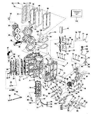

I have a 1979 Johnson V4 115TL79R . Is it as easy as rejecting my carbs with jet off a V4 140TL79R to get more hp out of the motor ? As I look through the parts book both motors take it seams like the same parts. carb kit ,pistons ,rods crank ,etc. the only difference I've found is different part #s for the heads. just doesn't seam that easy . thanks in advance ..

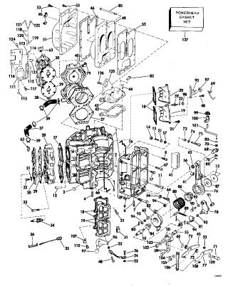

Just resetting your carbs will not help & in fact will hurt your performance. The motor will just use more fuel as already mentioned. I have attached the parts pages of the blocks of the two motors so you can see the difference in the exhaust. The 140 has what is termed a bubble back exhaust system (think headers). See attachments. The first should be like your 115 & the second is the 140. These pictures are from 1977 because the 1979 books list all of the motors the same (even the 85hp). Later OMC made the 115 a bubble back motor & the 112 SPL. This all had to do,with rating HP changes after 1984. Hope that helps.
