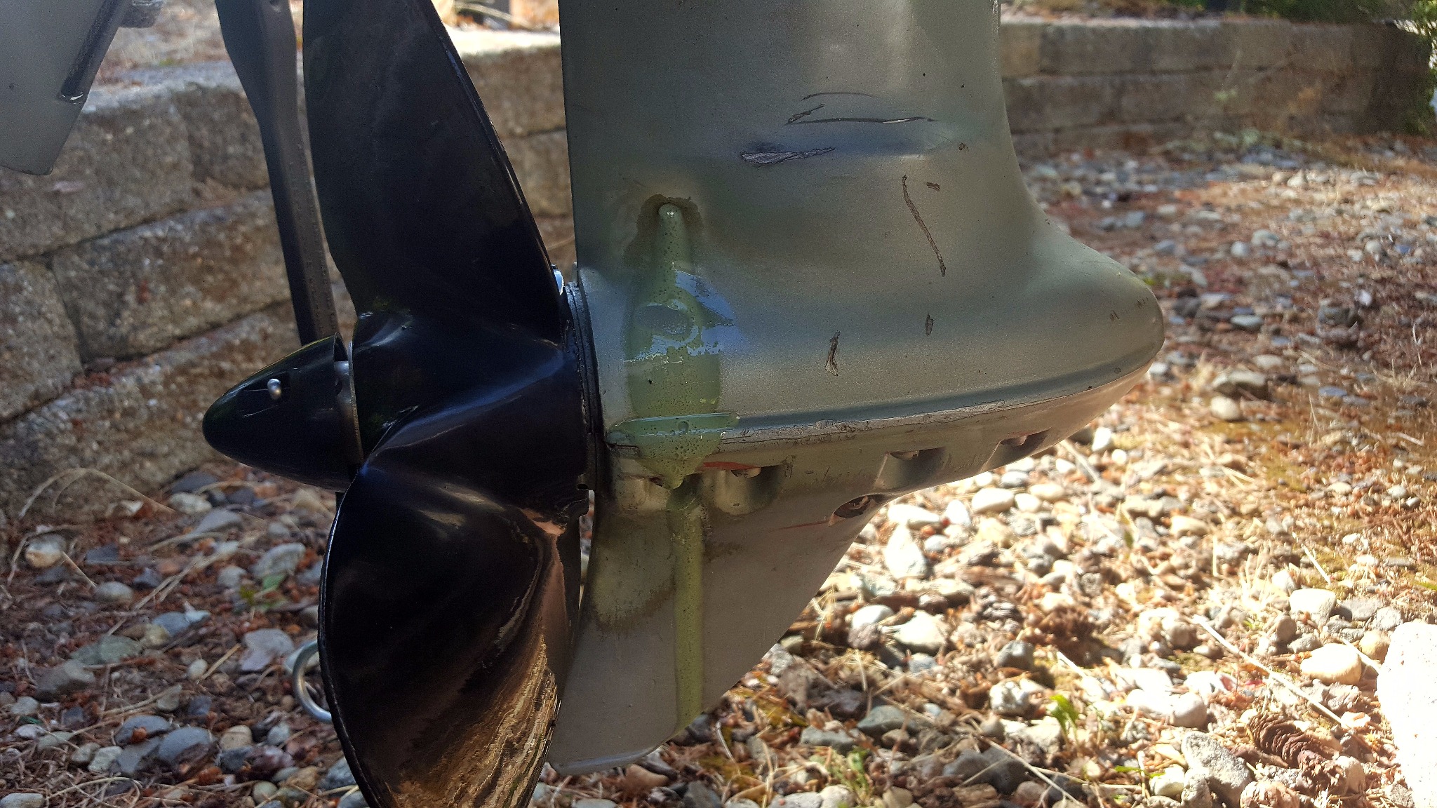

My '59 35hp Evinrude does the same thing. I changed all the seals in the lower unit including upper drive shaft seal. My shift seal was probably original and had the biggest leak during the pressure check. The picture below is from the day after running the outboard on the lake all day. It smells oily and after a few more days it went from a foam look to straight oil. I've been told it's normal, but find it difficult to comprehend it to be normal.
The outboard ran great pretty much all day.
1958 Uniflite>
Crafted in WA state
Powered by Bearcat

That amount of leakage is NOT normal! Looks like gear oil leakage to me. If you pop the drain plug on the lower unit is the oil still clean, or does it look like that grunge? Do you have a picture of the "straight oil" coming from that drain hole?
If that discharge has a sulfur smell it's definitely gear oil. But if the gear oil is clean, then it's coming from the upper end, because if any oil escapes the lower unit, water will take its place eventually. Lack of water confirms non-leakage.
Normally any oily discharge we're talking about is more of a seepage and maybe it's a good sign that the foam has changed to straight oil, but I'm left wondering how much. If just a small amount I'd consider it normal, but if it's still leaking the same amount as the foam, that's quite a lot. Maybe the engine cleaned itself up as it was run more.
Anyhow, a pic of that would help.............ed
