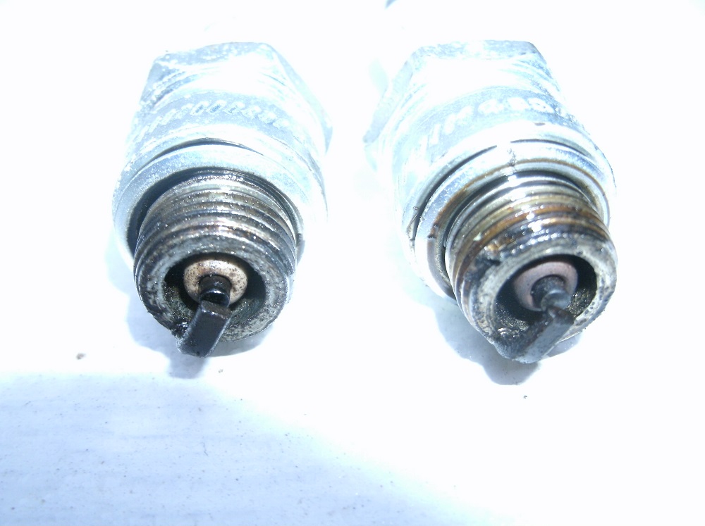

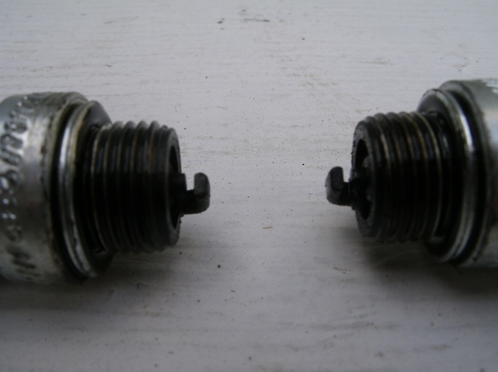

Here's the plugs after about 13 gallons of 50:1 mix. Top left, bottom right. They don't look too bad but they had only been test fired before Tuesday. Should I go to 40:1 or stay put ? There's a couple shots of the lower Grand River by Port Maitland Ontario. There's a pretty neat boat graveyard there too. Tons of blue herons, terns, and cormorants flying around too. My camera sucks tho so those pictures were dark for some reason on a brilliant day. Have a great day !

Top plug is quite different in appearance from the bottom. Maybe not firing well. Also could be water-washed although it's not really really clean. Next time out swap plugs then pull right after running for a while. Check for water on the plugs, if you have any it's a sign of a blown head gasket. A compression check might tell you something.
Also could be a sign of poor combustion from ign problems so best to go thru the ign to rule out that issue.

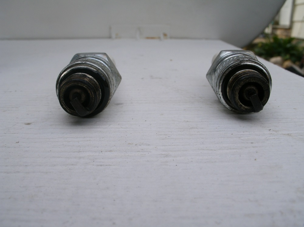

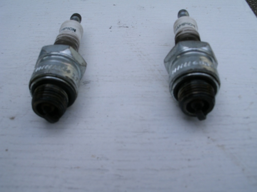

She's still not giving me any love. Here's the plugs after about a 5 hour play day, half idle, half WOT, I've gone a full turn by the end of the day and at this point I'm about ready to cave and take her to the shop for a proper tune up. I got her running late but I'm not giving up on this season just yet. If I have to spend a couple hundred (please just be a couple hundred) to get her best well I'm gonna do it. I made it run but I'm nowhere near smart enough to make her sing. Sometimes you just gotta let someone else tweak it. Thanks for all the help AGAIN. :) How's the 90 coming by the way ??

Looks pretty rich, did you screw the idle mixture jet in (clockwise) until the motor coughed and died? If not, then you don't know what the "too lean" setting is for your idle mixture.
I've found on plenty of motors in the past that someone has messed-up the idle setting and moved the knob/lever. It is held on by the tapered screw in the middle, once you loosen the screw enough, it will rotate on the idle mixture needle's shaft, or you can pull it completely off and "re-clock" it. Ideally, at the best, smoothest idle mixture setting where the engine is "happy" and doesn't "sneeze" or bog when you take off, you set the knob/lever so it's at the mid-range of its adjustment. Then you have a range of rich/lean adjustment to play with.
Try that and see what happens. On the flip side, both the plugs are burning the same!!

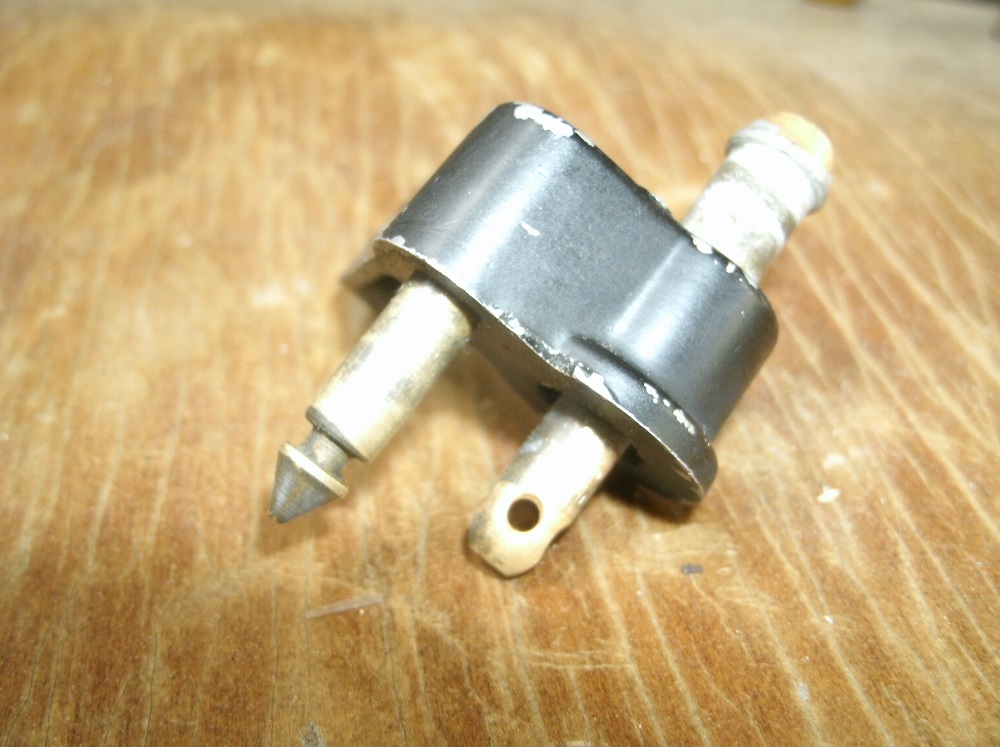

I'd say more-than-likely it's the female fitting on the portable tank's fuel hose that's leaking. It contains an O-ring that gets worn/damaged and then will leak like a sieve. Recommend renewing that plastic fitting, it's cheap and will probably save a lot of grief. If the male end is showing wear, too, by all means get a new one if they're that cheap. That way both ends will be brandy-new and no leaky-leaky!
BTW with a leaking fuel fitting, the engine's fuel pump will be unable to maintain the prime on the system and it won't pump fuel efficiently from the tank (if at all). Won't idle good either!
Many times I've seen a motor that would idle poorly or die after a few minute's running, have a bad fuel fitting, leaking/fouled fuel pump check valves, or some kind of "fluff" in the carb that was preventing a good seal from being made.

Fortunately my Merc buddy Steve has a great stash of boat stuff so we changed the females first, then we found the fitting on the motor wouldn't keep a seal no matter what we tried, it just went back to a position where it leaked as soon as I squeezed the bulb to prime. Gonna change them all. Maybe my carb isn't the issue at all ? Thanks.

If you're just messin' with the fuel connections you can just bypass the connector and splice the hose from the fuel tank directly to the fuel pump. Saves a lot of grief.

All the fitting does is make the connection portable. If you don't have any issues with that, eliminating a potential place for leakage will have little downside! If anything, it'll pump better and the carb will be properly fed with fuel. Just run it like you normally would and see how she does.
1961 Evinrude 40HP Super Quiet Big Twin won't idle 8 years 10 months ago #133734
Well Gentlemen I think that's a plan. I can always disconnect it from the tank and leave the line attached to the motor if I need to move it or I can just undo a hose clamp and pop it off there. I know I run a smoker but I'm not liking dumping gas into the water at all. Supposed to have a couple decent days this weekend so I'll let you know how it goes and THANKS again for all your help.
