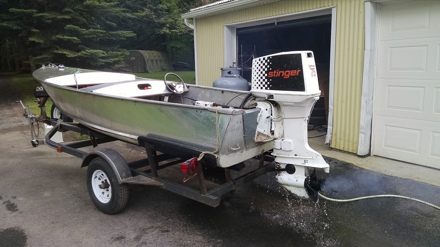

I picked up a 1979 Stinger the other day hoping to replace the 65 Mrec on my Gruman 14ft Alum hull. The 65hp woujd run 37 to 39mph depending onall the usual crap. I hope I can pick up a few with this. I have never had a Johnson or Ev. before so I have questions.
What do I need to watch for on these engines. things that are known to go bad. Props, are there any that work better than others? It has no pwr trim and I would really like it. Big job to change? Any tricks? Are these finicky at all? Please any info would be great.

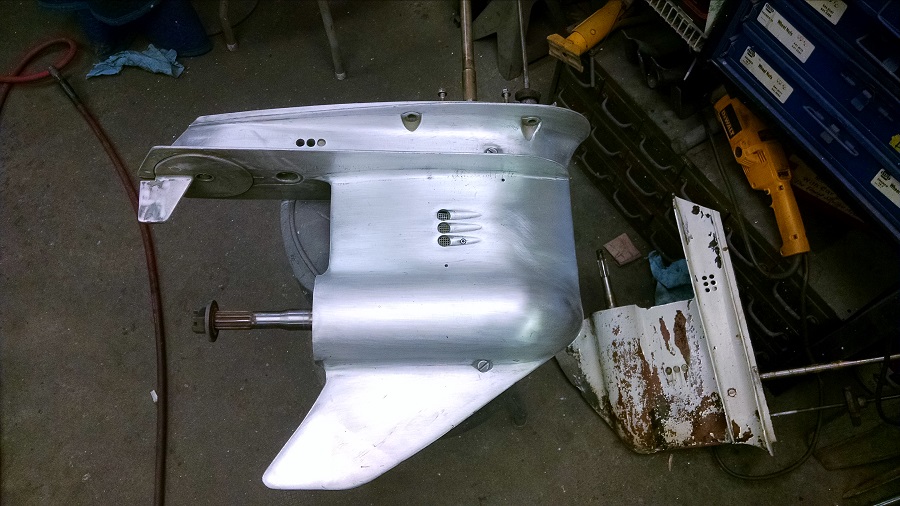

Well now I know why I got the Stringer so cheap, The lower end is junk. Runs great just won't move the boat, go figure........ So now I need a gear case all loaded up ready to go. Anyone have one? or what do I look for?

No, the 1973 will NOT fit. About 1976 OMC changed gear feet on the triples. 1973 to 1976 were hydromechanical shift. 1977 & up were straight mechanical. They shifted backwards from each other. It is possible to make them fit, but is a fair bit of work to swap the bell crank and shift bits. Requires powerhead removal. Easier to just find the right lower unit. You are looking for 1978 to about 1985 lowers with 4-sided upper driveshaft splines. Easiest way to tell visually is look for the housing with the swept back skeg. Later gear cases look similar but use a fine spline shaft. Again, possible to swap driveshafts, but would need a tech to do it so it can be properly shimmed, etc.
I love my 1980 Stinger 75 (same as yours). It runs about 42 on my 15-foot Starcraft American 15. Make sure you prop it to spin. They do NOT like to be lugged. Aim for 5800 RPM at wide open with a light load.

No, the 2-cylinder lower units are different housing, different shafts, different gears, etc.

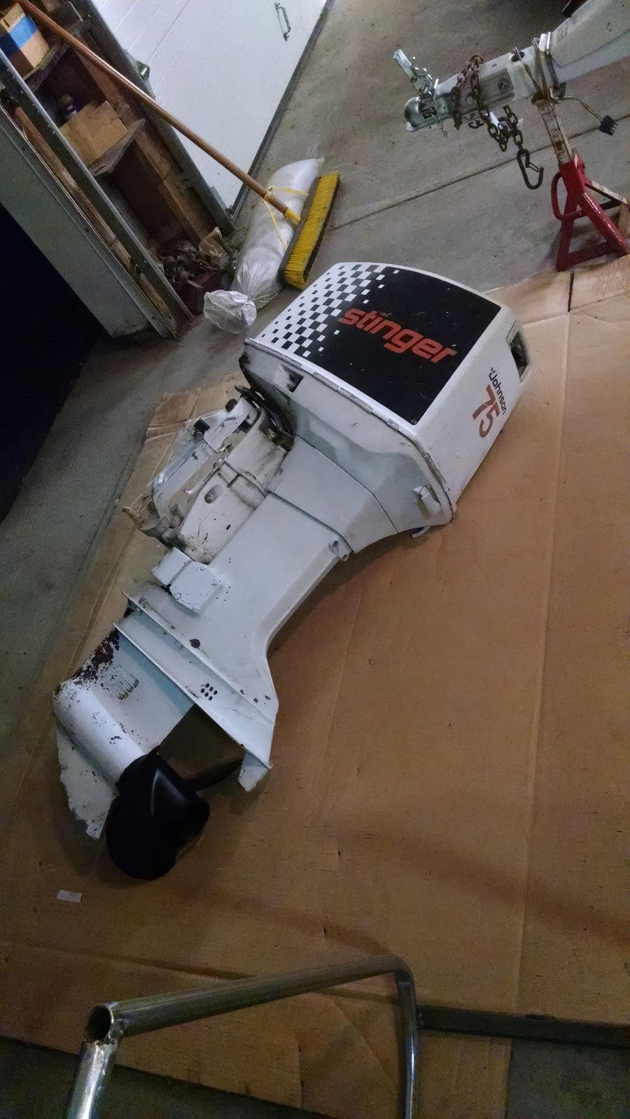

Today I got one thanks Don and I truly enjoyed the tour. Oh, I think my partner will take that hood we looked at. Wish I had taken some pics of it. Again Thanks so much Don.
Getting it ready for install, hope to be on the water tommaro if the sun ever comes back.
