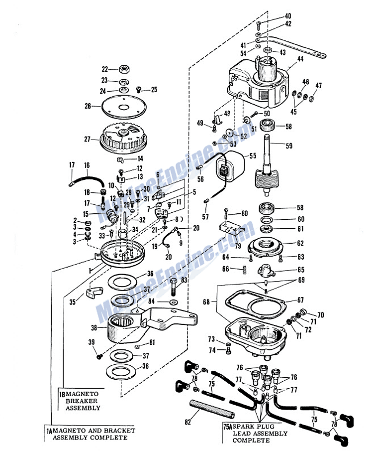

bruce gerard wrote:Also check that the resistor wire (a cloth woven covered wire) that goes from the coil to the motor wire harness isn't failing. These were originally 1 to 2 Ohms resistance, dropping the 12 volts from the battery down to 6 to 8 volts at the coil.[/quote]
Bruce, looks like this '61 75hp Johnrude has a magneto, hence no pesky resistor (ballast) wire, just the grounding (kill) wire at the side of the mag.
www.marineengine.com/parts/johnson-evinrude-parts.php?year=1961&hp=75&model=V4S-13&manufacturer=Johnson§ion=Magneto+And+Distributor+Group
