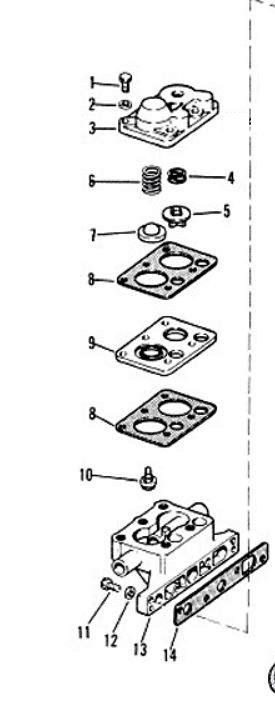

With everything gone, water will likely just go out the exhaust relief ports with none getting to the powerhead.
Be sure you get the plastic check valve/Vernatherm valve along with their springs, besides the Vernatherm thermostat.

Vernatherm spring:
Misc parts which include the 2 plastic valves and the 305587 check valve spring, which is pretty scarce:
Check Valve:
www.ebay.com/dsc/Boat-Parts/26443/i.html?_vxp=mtr&_from=R40&LH_TitleDesc=1&_nkw=305654&_sop=15
Vernatherm Valve:
www.ebay.com/dsc/Boat-Parts/26443/i.html?_vxp=mtr&_from=R40&LH_TitleDesc=1&_nkw=308070&_sop=15
Vernatherm:
www.ebay.com/dsc/Boat-Parts/26443/i.html?_sop=15&_vxp=mtr&_from=R40&LH_TitleDesc=1&_nkw=377276&_trksid=p2045573.m570.l1313.TR0.TRC0.H0.TRS0&_osacat=26443&_odkw=308070
HTH.........ed

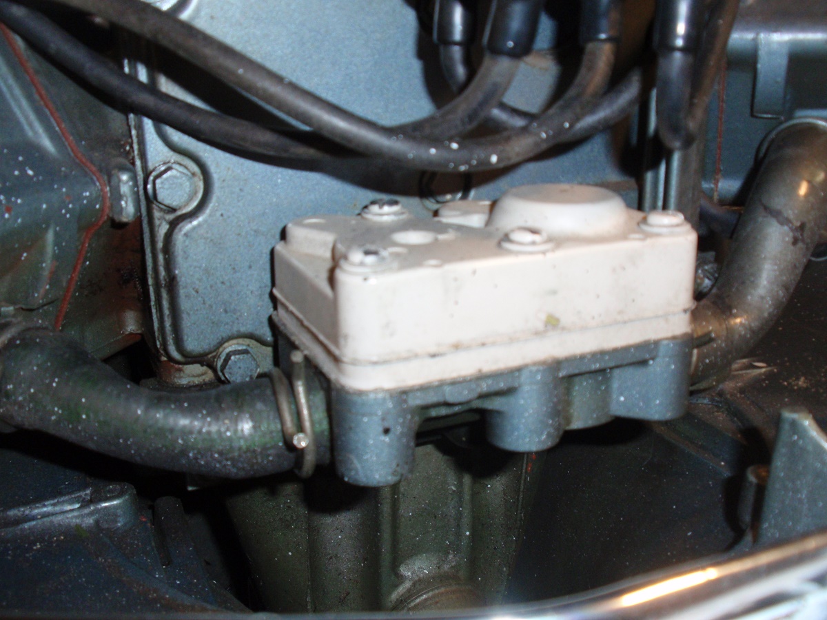

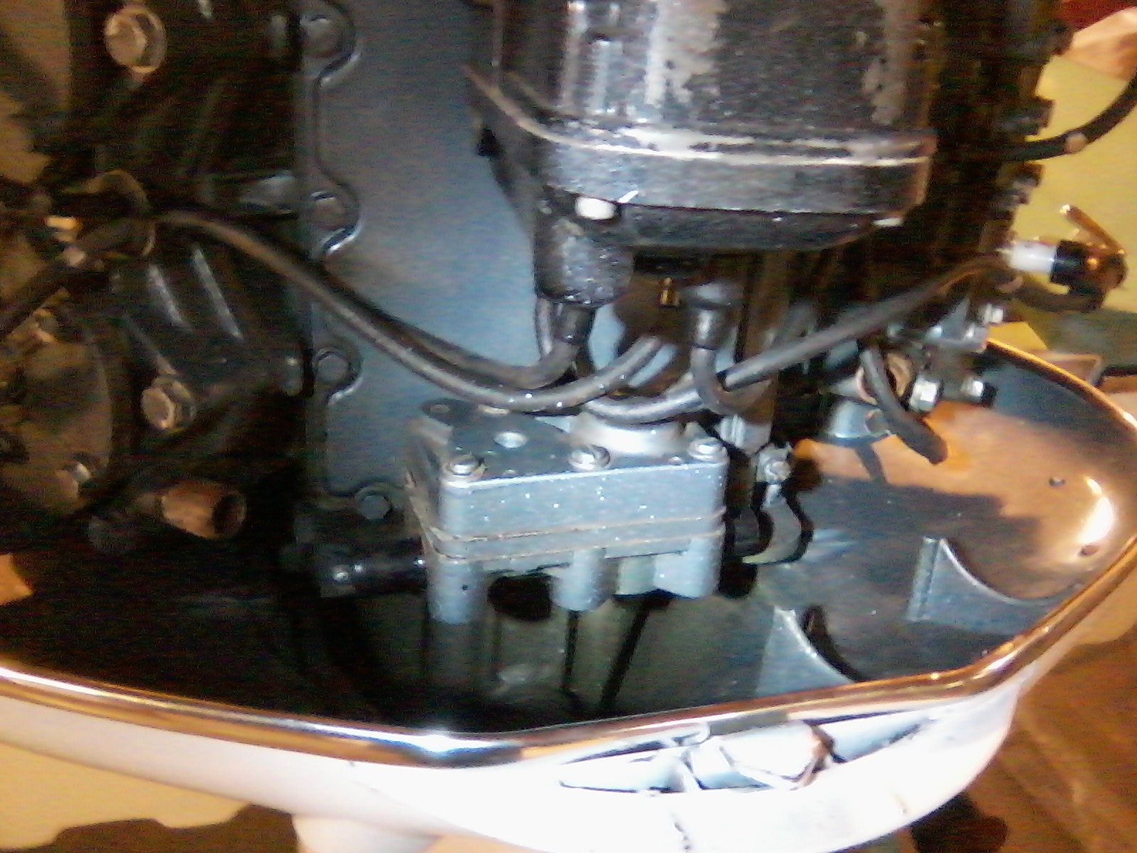

Ed, gulp---you were right, mia-culpa. I ordered the part and it was wrong but the seller was gracious enough to take it back. So I stayed local which I should have done in the first place. Two miles north of me is Green Bay Propeller greenbayprop.com/We're good friends and known each other for many years. Joe let me out in the bone yard with a screwdriver and I picked a complete thermostat from an old Johnson meteor. Perfect and everything was complete. I would highly recommend them to anyone looking for old parts of any brand. No one will get the deal that I did :laugh: but they have a bone yard with just about everything you could imagine. Their website doesn't cover a fraction of what they have.
