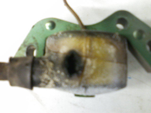

hello mike,i got the carb back together and put a new float in as mine had a big chunk out of it and seemed heavy then i decided to check spark again and this time the bottom plug was oil soaked. so i pulled the flywheel and found the coils so badly broken( the clear plastic housing) that there were pieces laying on the points housing,and the points are set at around .028 instead of .020, so im going to put two new coils, points, condenser and wires and plugs. also i learned that i can change my oil mix from 24:1 to 50:1. so between all 3 things maybe it will run better this time. everybody keeps saying i should be able to pull a skier so i have high expectations this time round. i ordered my parts through napa so should be back together tu, wed. i will keep you posted. thanks clinton

got new parts installed today. one of the old coils had a hole burned through it and was arcing on the mounting plate. the motor sounds really good in the water barrel. headed to the lake tomorrow for more testing and tuning.
