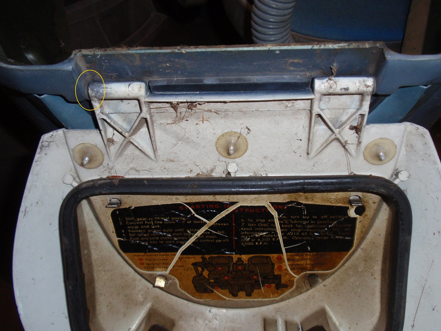

Anyone know how to remove this door hinge pin?
Re:Starter door hinge removal 9 years 10 months ago #129542
Looks like they drove it into a blind hole on the door. I think I would dremel the inside of the door boss enough to get access to the back of the pin and drive it out. You can always epoxy it over afterwards, but I don't think it will show anyway.
