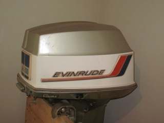

Thank you for the reply. Here is a photo of the motor it most likely is a 1972, what do you think?

It's around that vintage.
The 100hp was produced in '71 and '72, if you can post the model # off the I.D. plate we can narrow it down for you.......ed

The striping on the hood is 1972 vintage.
