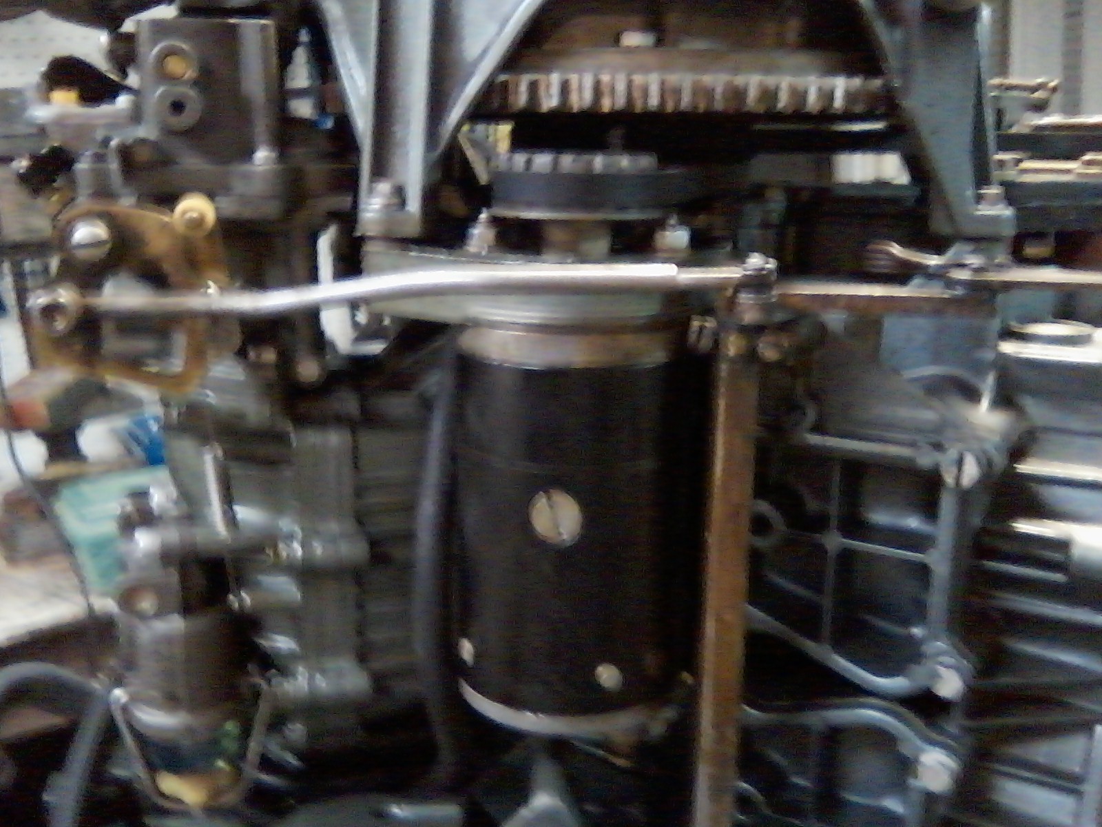

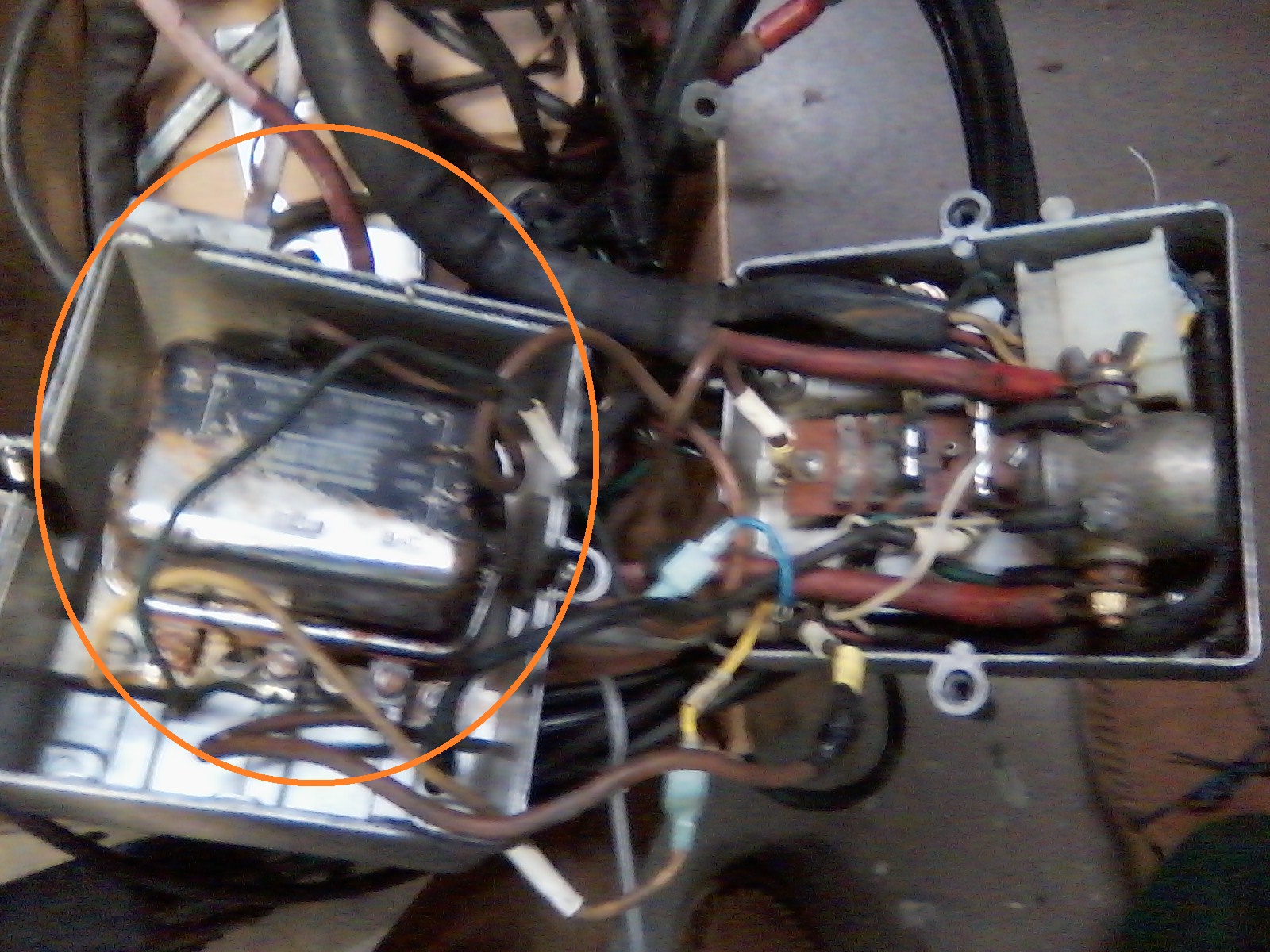

Re:Hooked up battery backwards, motor won't recharge 10 years 1 week ago #128423
I suspect you have a generator not an alternator. The generator will look very similar to the starter motor but on the other side of the motor and is driven by the same type of belt that drives the distributor. Your trouble just might be a simple as a dirty or loose connection or bad cracked shorted wire. The voltage regulator on my '65 Evinrude is located inside the same box as the starter solenoid and fuses. Check those connections and fuses. You can also remove the cover of the regulator and make sure all those contacts are clean.
Re:Hooked up battery backwards, motor won't recharge 10 years 1 week ago #128440
In addition to sabres advice, If have box like 63 sabres check - 1-fuse - may be a quick and easy fix (fingers crossed!), 2-starter relay, 3-voltage regulator. 1st 2 cheap regulator can Be pricey.
If checking fuse, use a multimeter - fuse can look good and still be bad - although with that kind of reversal it would probably be pretty visible.

Re:Hooked up battery backwards, motor won't recharge 9 years 11 months ago #128742
The Meteor had a Uni-Charger alternator under the flywheel. The belt driven device on your Meteor is the distributor for the ignition system.
Your engine may have an in-line fuse holder just ahead of the rectifier / regulator. I believe it is mounted on the flat area at the back of the motor, between the cylinder banks. This is a black bakelite plastic part with a wire coming out of each end. One end of the fuse holder twists off and inside, there is an automotive fuse. It is probably blown out. Replace it and see if the system works. It is also possible as mentioned above, that the rectifier / regulator were damaged, and will have to be replaced.
