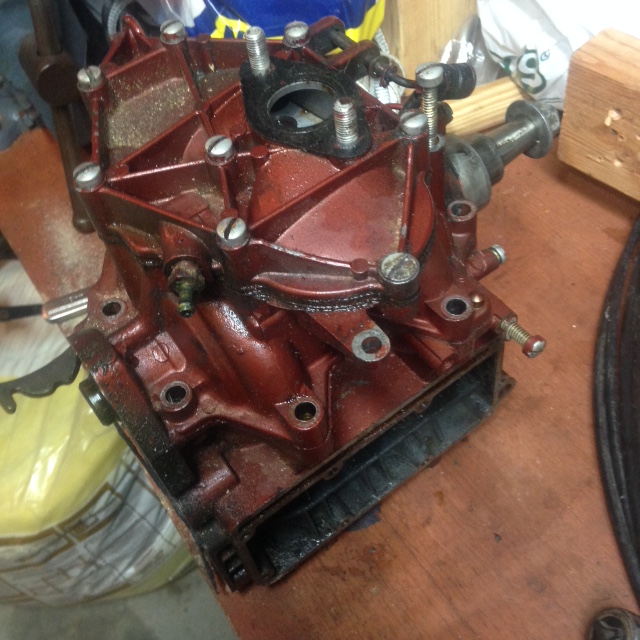

Months ago I picked up this motor for $15 in an auction. It is seized but everything is there and I finally got the ambition to start taking it apart. Started with a good soak with Deep Creep and taking off the head, and intake and exhaust covers. Weeks of soaking and trying to break it loose with a hammer / wood block and a breaker bar on the crank. No joy.

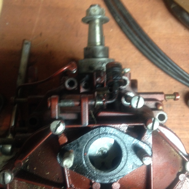

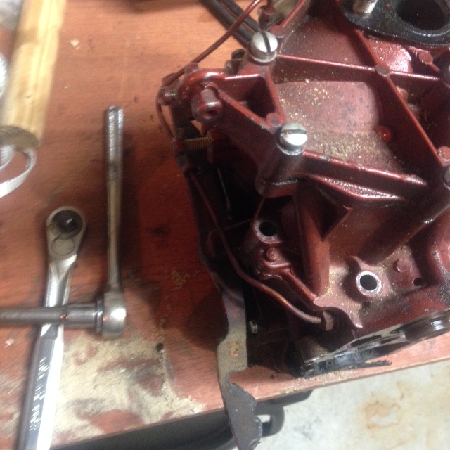

Ended up taking off the powerhead last night with the intention of splitting the case to see what I have. I have all of the bolts off, but nothing is budging. I was hoping that I would shake things loose a little without having to go this far, but now that I am here I may as well finish up.
Any suggestions from the gurus? I would prefer not to split the case if I can, but I think I am up against it and that is the next logical step. With the powerhead off last night I clamped it to the bench and put a 3/8 socket into the bottom of the crank where the driveshaft goes. Pretty tight fit and I had good leverage, but nothing moved.

Got it apart without brutalizing it - I had missed the 2 bolts hiding under the reed block. Good thing I brought it to my mechanic!
Pretty much everything behind the pistons is in great shape - shiny and oily!! Need new piston rings, a bottom seal, and a top o-ring, probably with a gasket kit. Update - forgot that I need a recoil starter for this one too. Not much good without that!

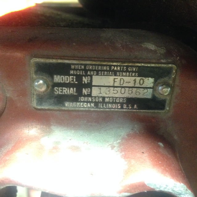

1956 FD-10 - no diagram on Marineengine. Any additional thoughts on where to go for the part #s?
