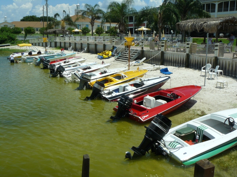

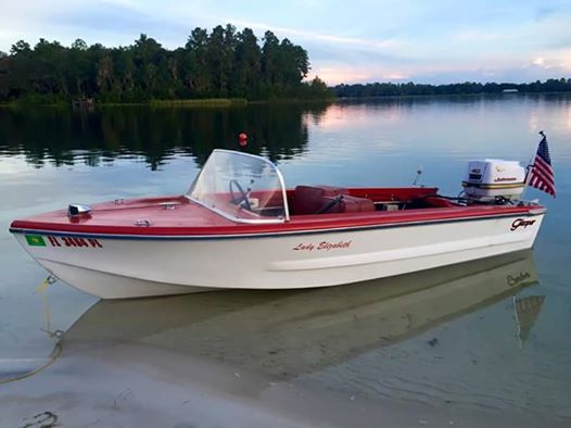

Re:Prop selection--Re: 16--Again!!!! 10 years 1 month ago #127226
Hello 16 Again!!
We in Florida need to get you into our Florida Glasspar Club, which myself and two other guys formed 12 years ago!! We now have 150 or so Glasspars of all makes and models in our club. All you need to do to join is own a Glasspar!!! No politics, no dues, etc. Just get together several times a year and play with our Glasspars in the Water!!! We also have our own website with chat and a lot of good information about Glasspar boats!!
We have a mid-west chapter now! Where do you live?????
WE HAVE SEVERAL SEDANS in the club and you can get much info about performance, restoration, engines, etc. on them!!
The two lower pics are my wifes 1960 Glasspar Tacoma and my 1960 Glasspar G-3 at 56 mph!!!!
Row of G-3s we had at a Rally in 2009!!
Jim Savage
Crawfordville, Fl.
Jim Savage
