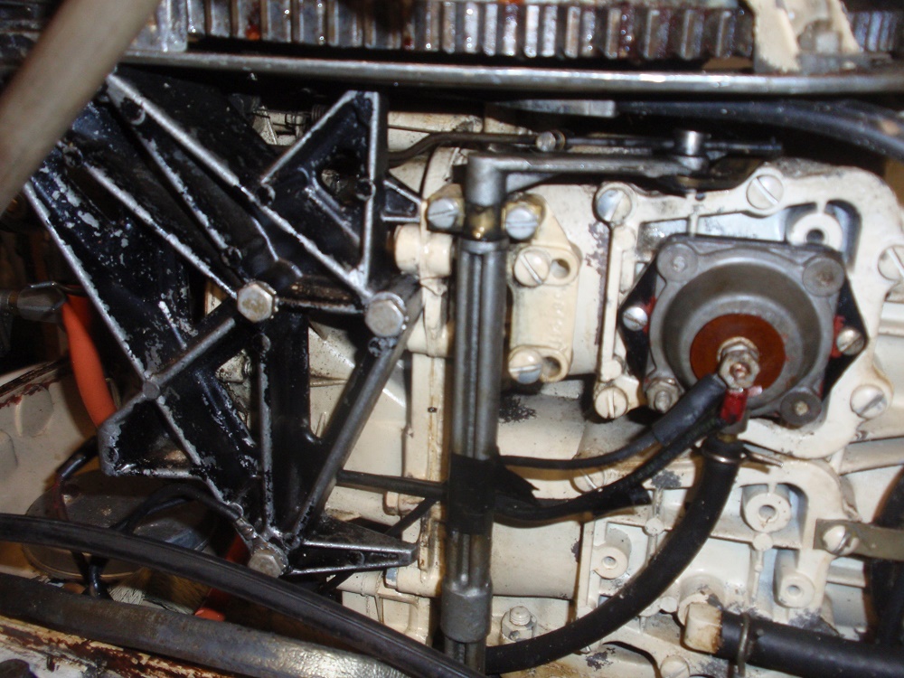

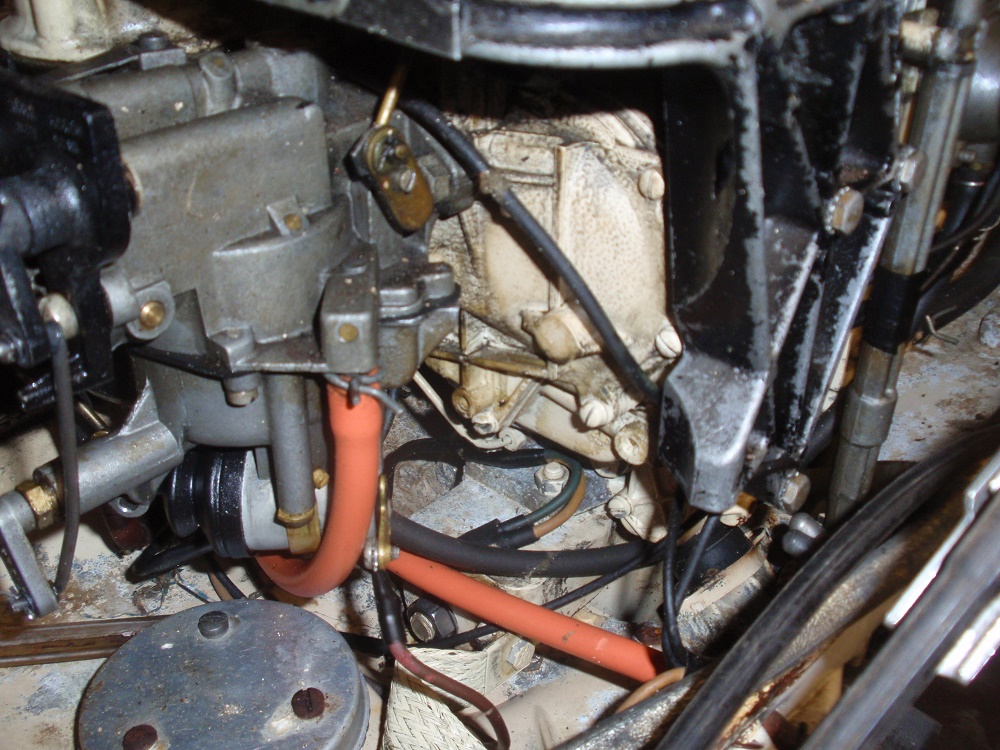

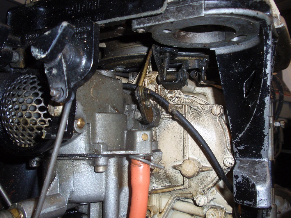

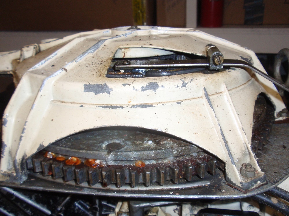

does anybody on here have a pic or diagram of how the linkage runs under the armature plate and hooks into the shift rod on a 1959 Evinrude 35hp Lark? Its the small linkage that connects to the carb and runs back. Also I am in dire need of an armature plate also. Obsolete part and ran across what I thought was one on Ebay (advertised as such), ordered and is not the correct part. Please help, anybody. Desperate here!!

Re:1959 Evinrude 35hp Lark 10 years 1 month ago #126959
Here are some pics from a '57 Johnson rds20 but I strongly think it would be very similar. Best I could do for now.
Pictures are from a motor before it was taken apart for cleanup.
Re:1959 Evinrude 35hp Lark 10 years 1 month ago #126963
Awesome!! Just what I needed! Thanks!
