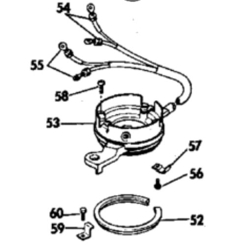

One thing I would do is disconnect the throttle cable at the engine. Then run the remote throttle up and down and see if the cable is sticking.
Do the same with the throttle arm on the engine. As you increase throttle, it should smoothly operate the carb linkage, and the timer base should move. Eventually you'll hit the spark advance stop and the spring-loaded throttle arm will continue to open the carbs to full throttle.
A very common problem on the V4's of this vintage is for the timer base to drag, due to corrosion buildup. Then you'll get erratic throttle operation and the engine may not achieve full power due to lack of timing; or the timer base won't go back to idle timing and you can't get the idle speed down to normal.
A good way to check this is to disconnect the linkage to the timer base. There's a rod attached to the throttle arm, with a ball on the other end that snaps into a plastic insert in the timer base arm.
Just snap the ball out of that socket and you should be able to move the timer base with your fingers.
If it's hard to move, or stuck, you may need to pull the flywheel to gain access. Pull the timer base and clean/grease the friction parts. If I recall the stator has to come off to get at the timer base.
Sometimes you may be able to just spray-lube from the bottom and loosen it up, then you wouldn't have to pull everything apart. But most times there's a lot of crud built-up and it'll have to come apart for clean/lube.
HTH & let us know what you find........ed
