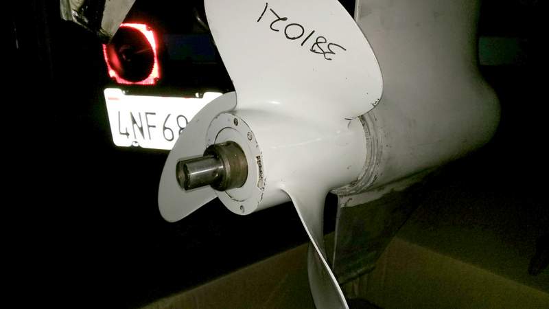

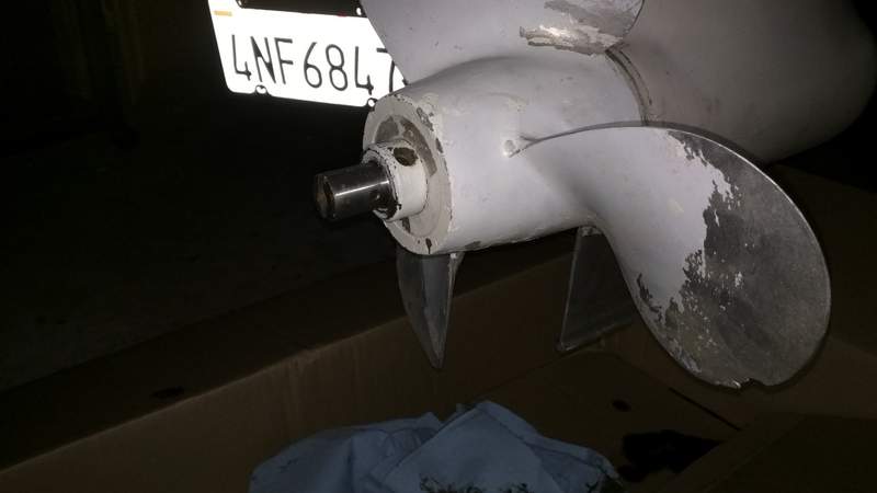

When I got my motor, both props were badly beaten up. One looks beyond repair and the other is showing lots of metal fatigue.
In any event, I have bought two props off of craigslist that are the recommended part numbers. A 381020 and a381021.
The prop that is on there now, which doesn't have an OMC number covers the entire gearcase head. However, BOTH of the replacements have a reveal of about 1/4" around. I'm not sure if it makes a difference or if it is because the prop on the boat is a 14 1/4 by 14 while the ones I bought were 12 1/2 x 16 and 18. In doing more research, it appears the 2 props that came with it are from OMC i120 sterndrives of the same vintage. I found a Michigan Steel number on one of them and tracked it down.
So are the replacements I got okay with the reveal around the edge?
I've attached two pictures that hopefully you can see what I'm talking about.
Re:1966 Johnson 100 Hp Prop Question 10 years 8 months ago #119926
Dave. I have the same setup with the two different props. As long as there is no "slop" or play, no binding you should be good to go. Put the shear pin in and spin the prop by hand. You might need a thin shim washer behind it. If you have to pull the prop forward to insert the pin you could use a shim.
When I put on the more aggressive prop (bottom picture) there was a big difference in hole shot and a slight increase in top end.
